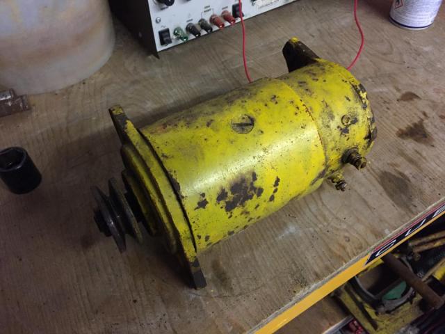

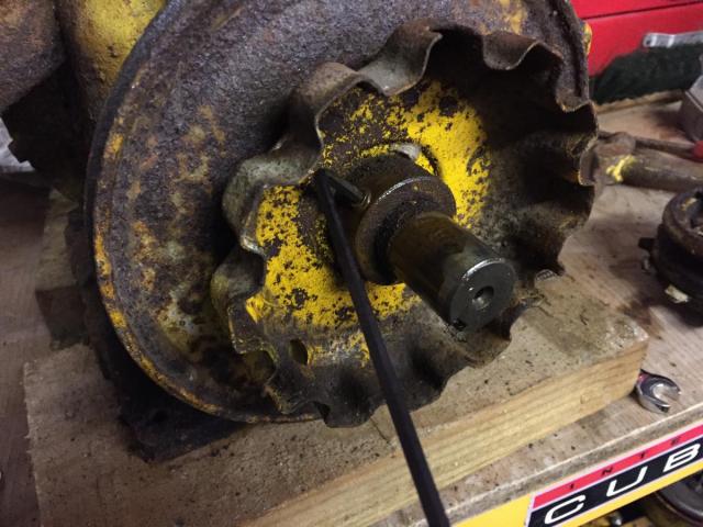

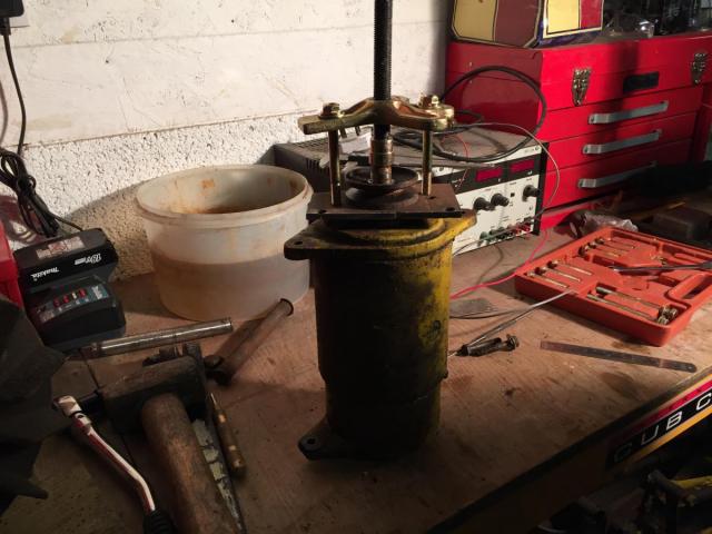

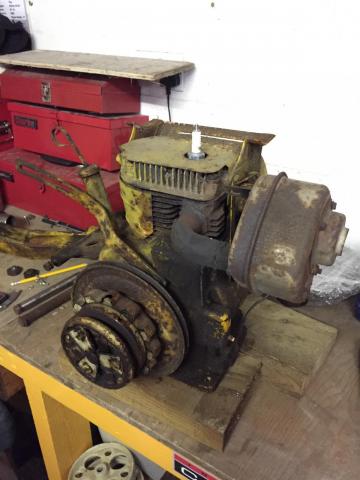

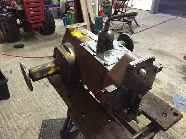

Cub Cadet 613 #30 Posted January 10, 2016 A little bit more done today, started dismantling the engine and starter generator. First I removed the pto and pulley. I have now removed all of the tin work and have started on the starter generator. 5 pmackellow, diggerjames, Triumph66 and 2 others reacted to this Share this post Link to post Share on other sites

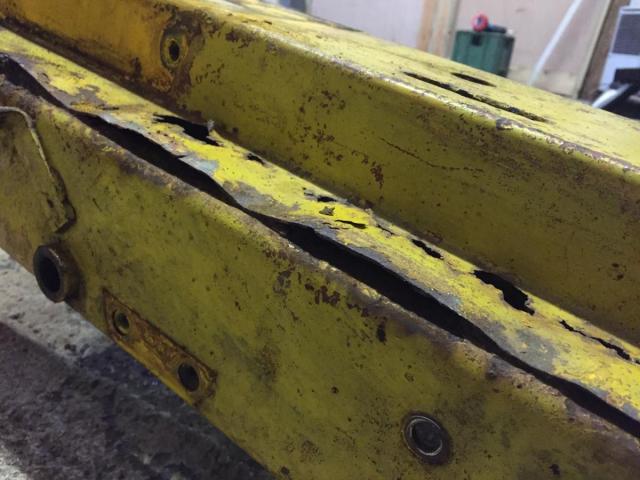

Ian 2,417 #31 Posted January 13, 2016 Nice work lad's, I'm surprised that thick metal had rusted away, as it does look like.. er.. thick metal A water trap maybe? Nice repairs by the way 1 Cub Cadet reacted to this Share this post Link to post Share on other sites
Wristpin 400 #32 Posted January 13, 2016 Nice work lad's, I'm surprised that thick metal had rusted away, as it does look like.. er.. thick metal A water trap maybe? Nice repairs by the way We had a customer living about quarter of a mile from the sea who parked his MTD ride-on in an open sided shed , always pointing in the same direction. The side exposed to the sea spray completely rusted away while the other side was more or less untouched . Fortunately MTD were able to supply a complete new chassis section which saved a lot of cutting and shutting. 2 Cub Cadet and nigel reacted to this Share this post Link to post Share on other sites
Cub Cadet 613 #33 Posted January 13, 2016 Nice work lad's, I'm surprised that thick metal had rusted away, as it does look like.. er.. thick metal A water trap maybe? Nice repairs by the way Yes it is a water trap, water had got in between the spot welds and the rust had expanded, heres a pic of the side we haven't fixed yet. Share this post Link to post Share on other sites

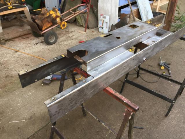

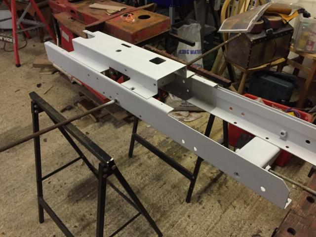

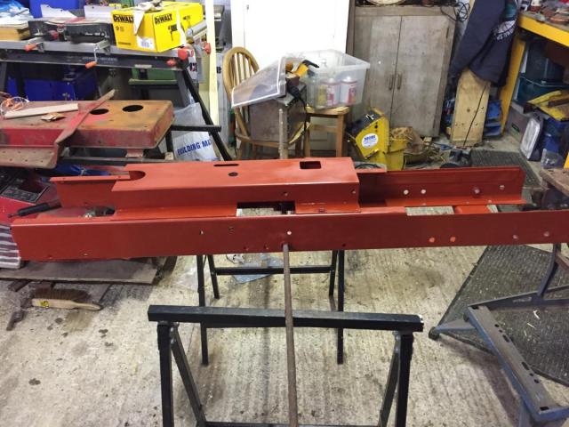

Cub Cadet 613 #35 Posted January 23, 2016 Been busy today cleaning up the chassis and painting, here's some pictures. I'm pleased with the result after a coat of etch primer, it feels like I'm getting somewhere now To help fill the rust pits I'm brushing on red oxide primer. My new toy arrived last week so hopefully it should speed up the restoration and hopefully I will be able to achieve a good clean surface so I can use etch primer. 6 Triumph66, Alan, Ian and 3 others reacted to this Share this post Link to post Share on other sites

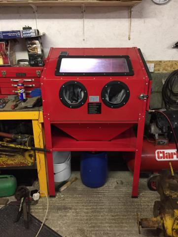

diggerjames 543 #39 Posted January 23, 2016 Brilliant work Ewan how you finding the blast cabinet? 1 Cub Cadet reacted to this Share this post Link to post Share on other sites
Cub Cadet 613 #40 Posted January 23, 2016 Brilliant work Ewan how you finding the blast cabinet? Thanks, I'm liking it, I'm putting everything in an E-tank first to clean the paint off, just so it blasts quicker but it is doing a good job, it's a good size so I will be able to fit my bonnet and wheels in there Looking forward to seeing this at Newby Hall Hopefully it will look like it has just come out of the factory 1 diggerjames reacted to this Share this post Link to post Share on other sites

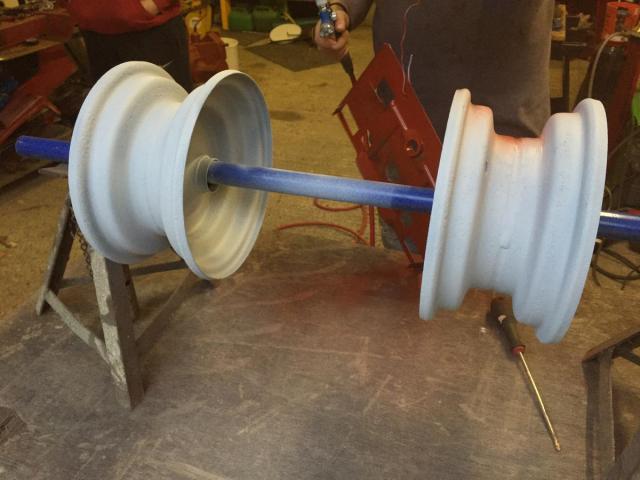

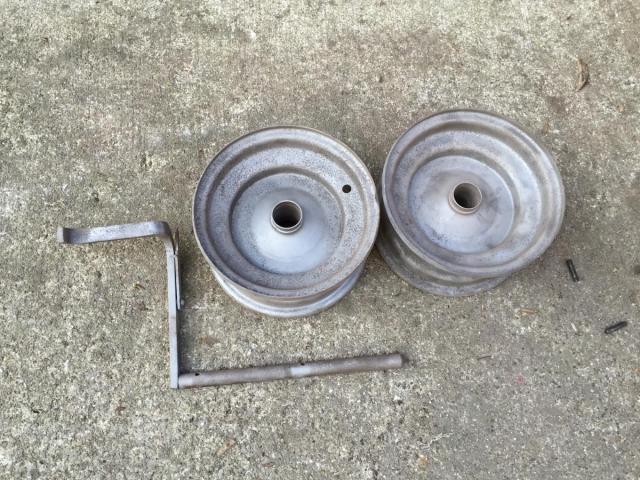

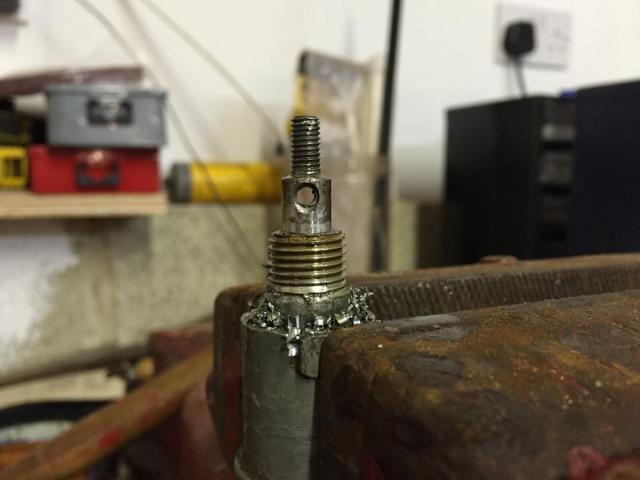

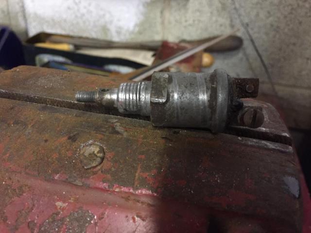

Cub Cadet 613 #49 Posted February 8, 2016 A little bit more has been done over the past few weeks , mostly cleaning up various parts and painting, here are some photos. The wheels and brake/ clutch pedal after sandblasting. After a coat of etch primer A previous owner of the tractor had stripped all of the threads off of the light switch and so the nut had to be cut off. After cutting the nut off I discovered this. Luckily we managed to save the light switch by cutting new threads 6 meadowfield, Alan, Stormin and 3 others reacted to this Share this post Link to post Share on other sites
