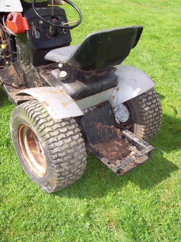

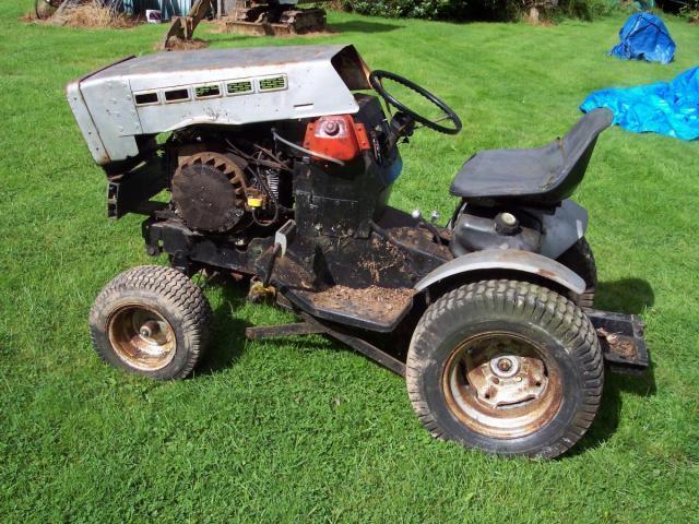

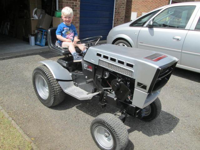

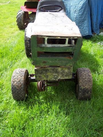

Alan 1,274 #1 Posted January 6, 2016 I have been intending to post this restoration since joining MoM last year but seem to have spent most of my time helping friend John dispose of his Bolens etc stash. As most of the stash has now been cleared I now have slightly more free time, so here goes. The number on the Roper ID plate,T5828DR, I have not been able to trace but the tractor appears to be identical to Sears 917- 257050. The Sears parts list, engine number etc confirms this. The tractor was a mess when dragged from the undergrowth at John's place about three years ago. Lots of damage, parts missing etc and a blacksmith repair job in various places. John was told when he bought it that it had been run into a post, smashing the grill and pushing the hood back which in turn badly damaged the plastic dash tower. As can be seen the damage was "repaired" via a heavy metal frame and alloy plates pop riveted on plus steel box section in place of the lower grill. One of the first things found was that there was no spark plug in the front cylinder of the horizontal Briggs twin. Hardly surprising as there was very little thread left in a hole which resembled a cone. Managed to fit a heli coil at a later date. Since then I have been given a pair of cyl heads. Also found that the starter motor was jammed when trying a first start. One magnet had come unstuck from the case. Stuck it back on with Araldite then found it ran in the wrong direction. Wondered if this was because of the glue used. Using a Westwood ? motor with the Sears mounting bracket and a temporary fuel tank got the engine running on one cylinder. A drive around showed that all the gears were OK. As the tractor looked do-able, with a LOT of work, the next step was to transport it to my garage so that I could get at it without 44 mile round trips to John's. Before the restoration bits, a photo of my great grandson Mini Alan trying it out for size. 9 Anglo Traction, expeatfarmer, wurzel and 6 others reacted to this Share this post Link to post Share on other sites

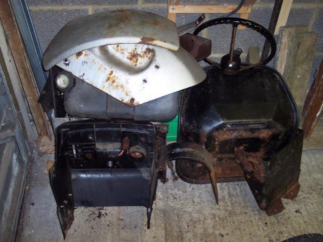

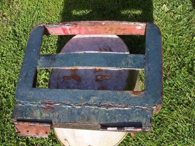

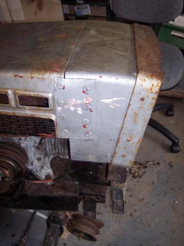

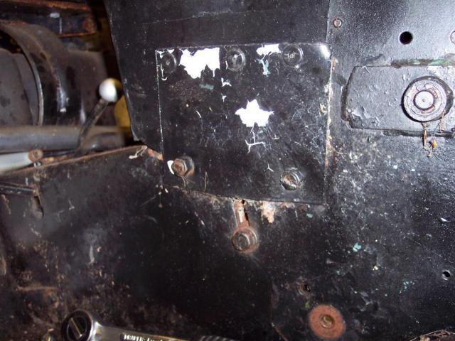

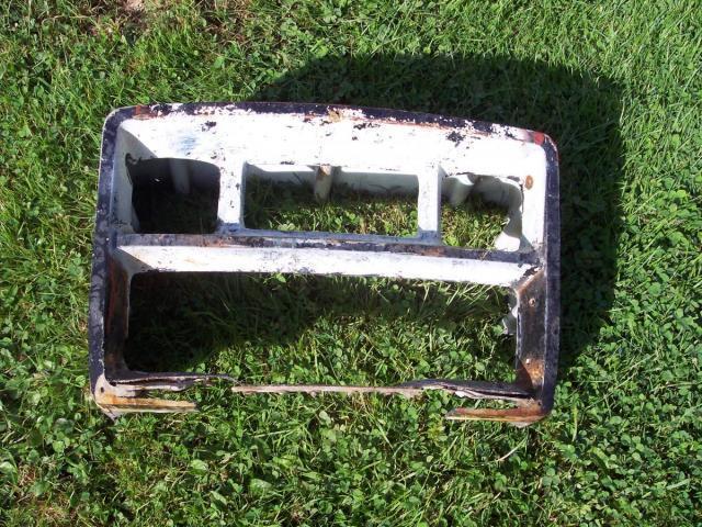

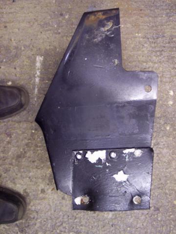

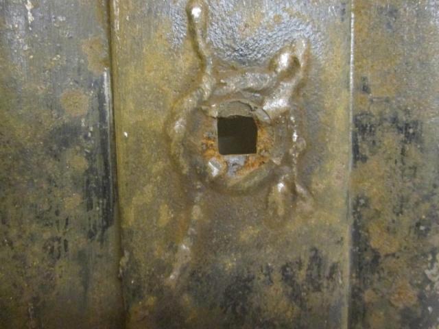

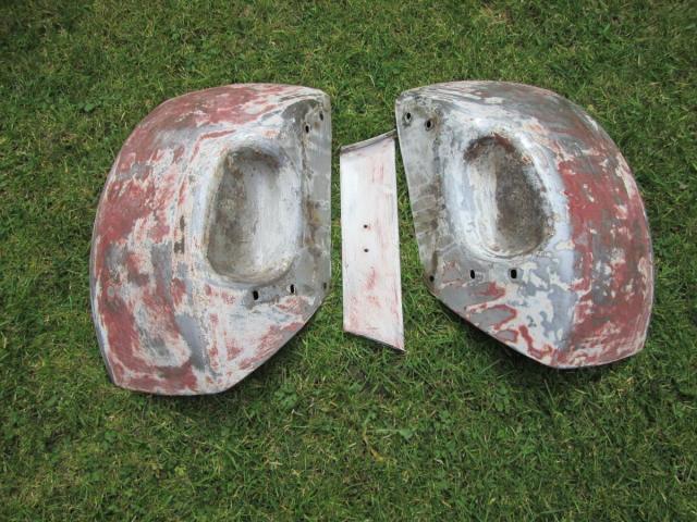

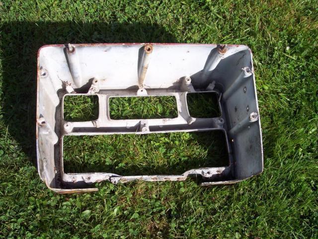

Alan 1,274 #10 Posted January 7, 2016 After transporting the tractor home and having a good look at the damage and missing parts, it was decided that a near enough non original option was the way to go. One of the first jobs was to remove the blacksmith "repair parts". The frame around the upper grill was a surprisingly good fit held on by nuts and bolts. The door butt hinges were welded on, for welded just imagine bird poop splatter, as one hinge had already parted company. The frame and the upper grill. The bit of tin at the bottom of the grill replaced the original hinge mount which had broken away. The box sections which replaced the lower grill were only firmly welded along the front face and were quickly removed with the help of a bar and G clamps. Some of the welds were good, others bird poop. Almost as if two different people had been at work. The engine was lifted off using the same bar. The heavy welded on plate which supported the box sections can be seen. I cut most of this off before realizing later that I could have reused it to mount the new lower grill. The tow bar extension, seen on an earlier photo was removed, two bolts and more poop spatter, to reveal more damage. The original tow pin hole ripped out and the plate cracked for about 1/2 the width along the bend. Could have been repaired but I went for a different option of which more later. After spending ages, on and off, trying all the usual ways to remove the well rusted on steering wheel, I resorted to cutting a slot in the hub and used a wedge to slightly open the slot. This freed the hub from the shaft. Other options suggested on various forums were a lot more drastic. Once the wheel was off and after taking lots of photo's to help with reassembly the major dismantling started. 7 pmackellow, Stormin, Ian and 4 others reacted to this Share this post Link to post Share on other sites

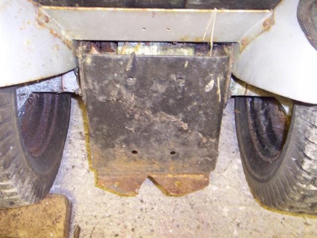

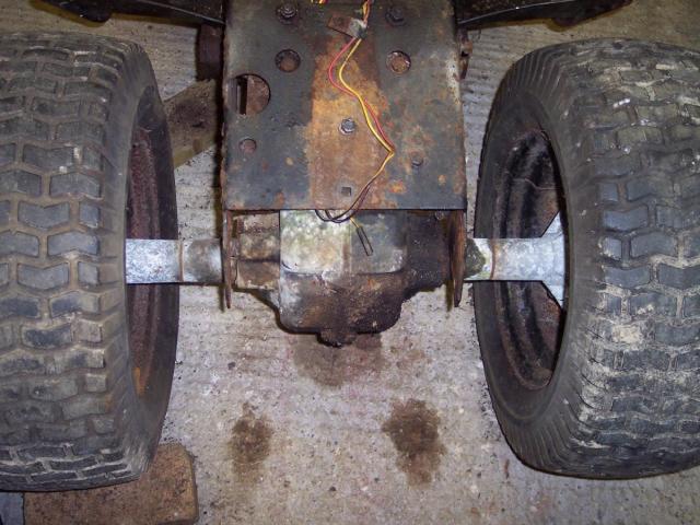

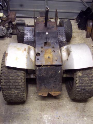

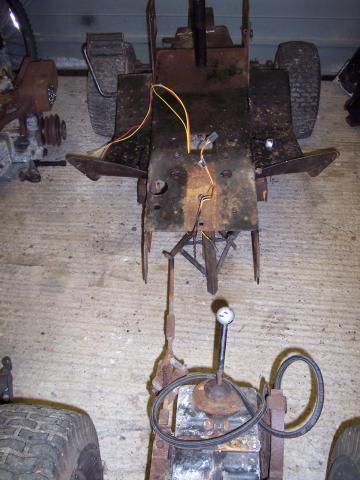

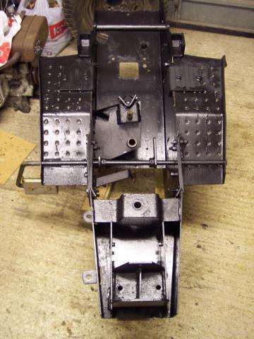

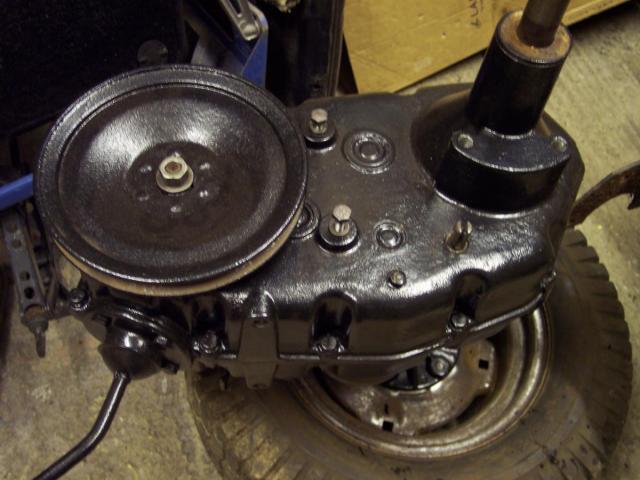

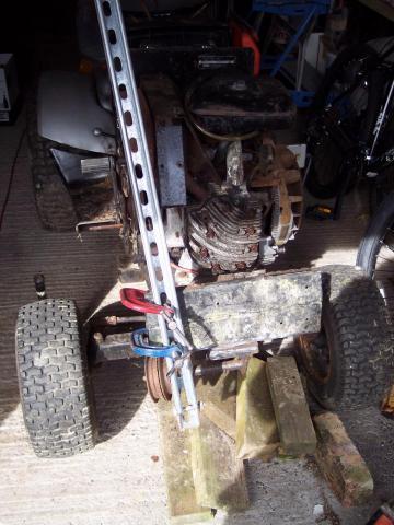

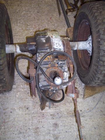

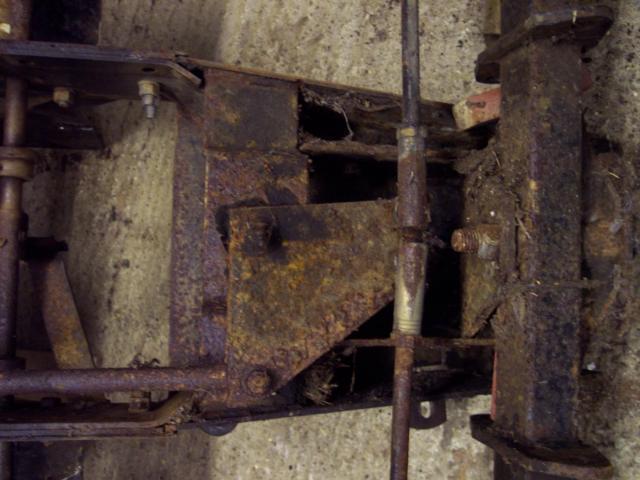

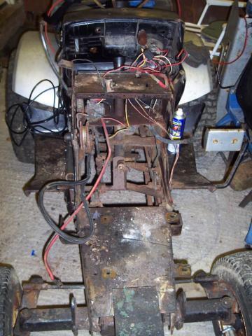

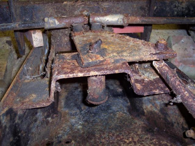

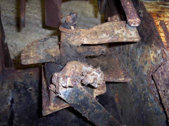

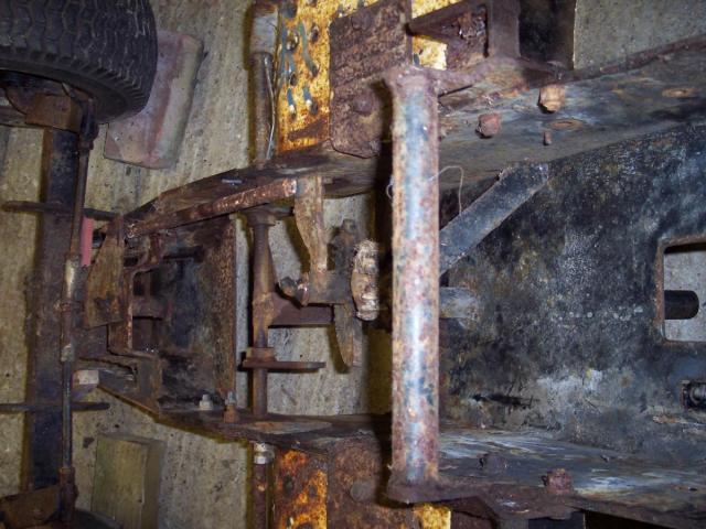

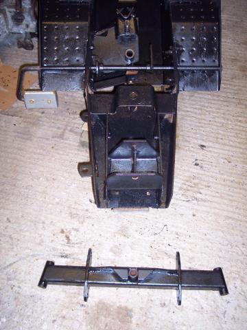

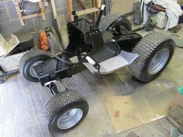

Alan 1,274 #12 Posted January 8, 2016 After most of the main components had been removed work started on cleaning up the chassis. Lots of crud, rust and dead wildlife which seemed to take forever. Some area's were difficult to reach due to various welded on brackets etc. The front axle and steering parts were removed after these photo's were taken. After painting the underside. Countless other operations, not all recorded, before joining up the chassis sections and transmission. This was a potential finger trapping job but luckily they survived. Very fiddly getting some of the nuts and bolts into position due to almost nil clearance between the inside of the chassis and the transmission. I can imagine when built, the frame would have been assembled first, upside down, then the transmission unit dropped in. Not practical for me with no overhead lifting gear or extra hands. I had lots of room in my garage then. Not now due to one of my son's moving back home, as they do, bringing loads of stuff with him, plus I have collected numerous "will be used one day" bits and pieces myself. 5 pmackellow, Ian, wurzel and 2 others reacted to this Share this post Link to post Share on other sites
the showman 4,074 #13 Posted January 8, 2016 That all looks a right mess, you did well to save it all. Looking good after some black paint 3 Alan, nigel and Joe the small engine man reacted to this Share this post Link to post Share on other sites

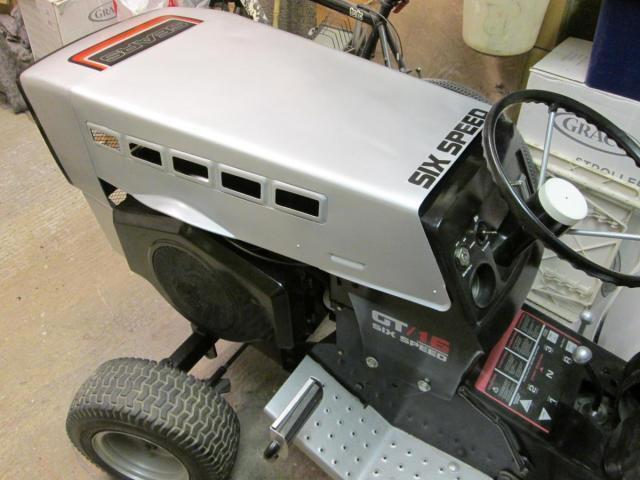

Alan 1,274 #15 Posted January 9, 2016 the colour scheme looks great! are you going to put AG tyres on it? Thanks Joe. As far as I know, this colour scheme was only used for one year, 1978. All four tires are those fitted when dragged out of the undergrowth. Not too bad condition although two had been flat for years. The idea was to leave them until the main work was finished and then maybe changing to something different. This is not likely to happen now as the tractor will unfortunately have to be disposed of due to lack of storage which is expected in the next few months. Various members will already know the circumstances of this. 2 the showman and nigel reacted to this Share this post Link to post Share on other sites

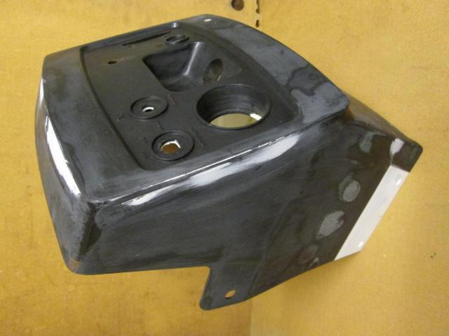

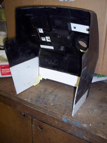

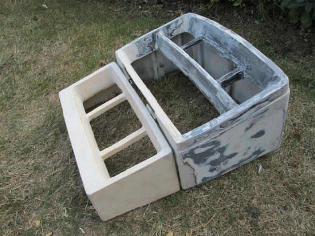

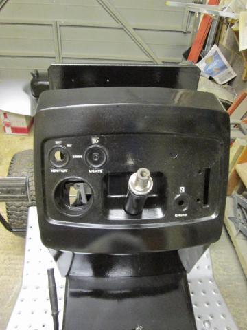

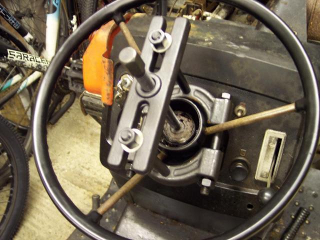

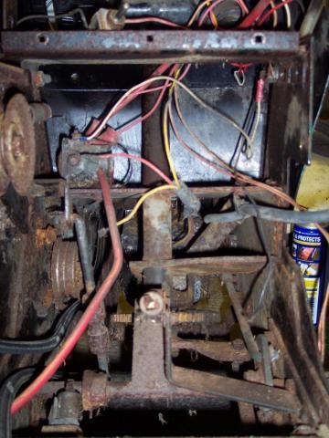

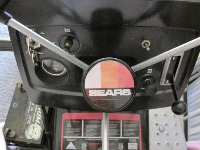

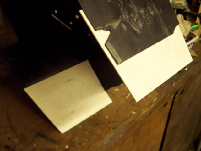

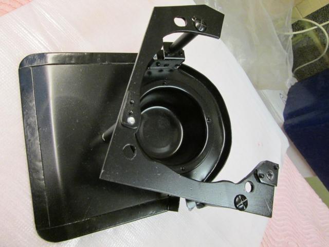

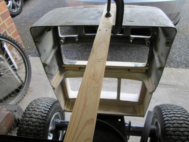

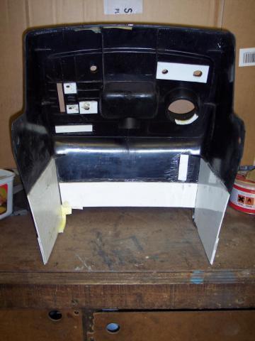

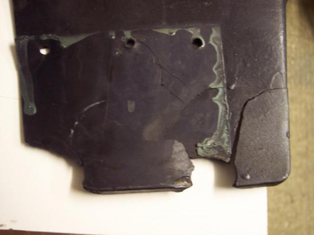

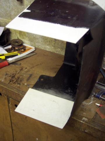

Alan 1,274 #17 Posted January 9, 2016 Lots of small boring jobs done then it was decided to tackle the badly damaged dash tower. Nothing available this side of the pond and the very few which popped up in the US were very pricey plus horrendous postage costs and were all also damaged to some extent. Speaking of nothing available in the UK, I have not seen or heard of any other of these larger Sears / Roper tractors. Various RT 8 and 10's but nothing larger. I expect they will start popping up now. Both sides of the dash were held together with alloy plates and enormous pop rivits. As I had a stock of plastic sheet "Plasticard" in various thicknesses left over from my radio controlled model boat building days, it was decided to use this for the repair. A lot of the lower sides were cut off so that a simple butt joint could be made using the first bonded on sheet to give extra support. As I was not sure if the glue I had was compatible with the moulded dash, ( found out later it was ) the first plasticard sheet was bonded on with araldite after roughing up both surfaces. The other sheets, to build up the side thickness and the shape at the corners were glued together using normal plasticard glue. Lots of cutting, filing and sanding and the dash finished up looking a lot healthier. There were a lot of cracks around the various switch, lever etc holes which were also reinforced. Finally it was trial fitted and after making sure it was sitting at the correct angle it was marked and drilled for the mounting bolts. This last photo, lots of reflections, is after painting and the moulded lettering gone over with white paint. A fiddly job. 6 the showman, Stormin, nigel and 3 others reacted to this Share this post Link to post Share on other sites

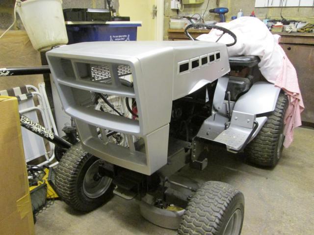

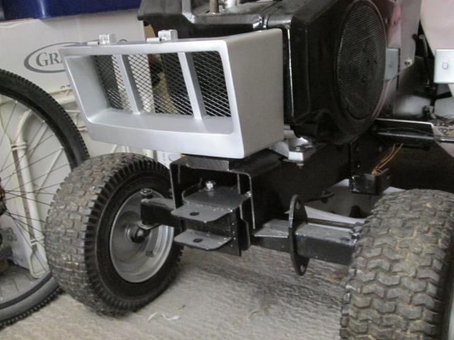

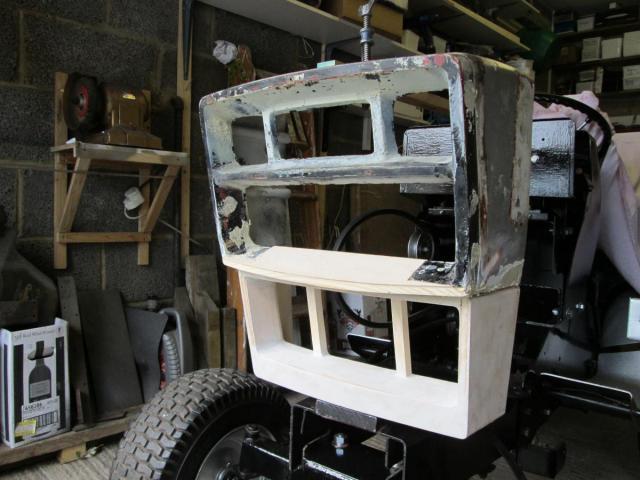

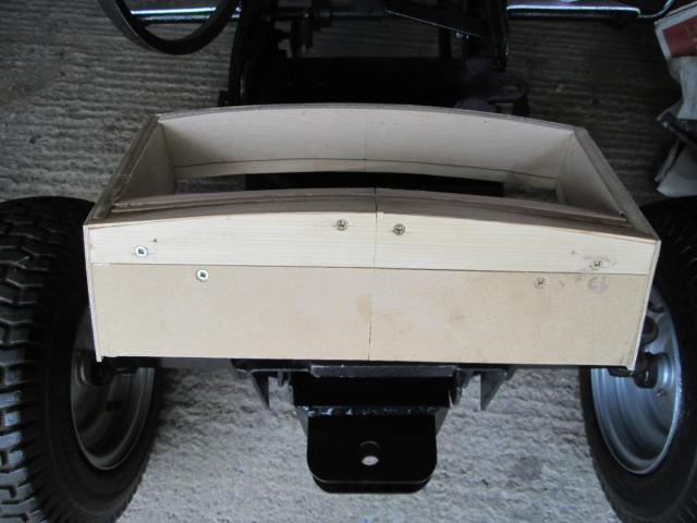

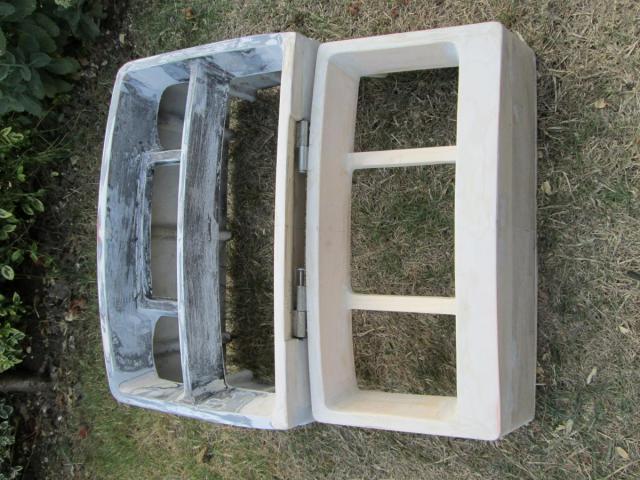

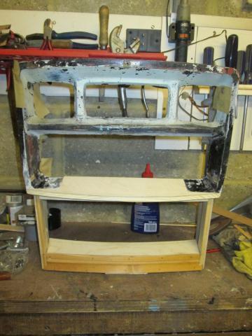

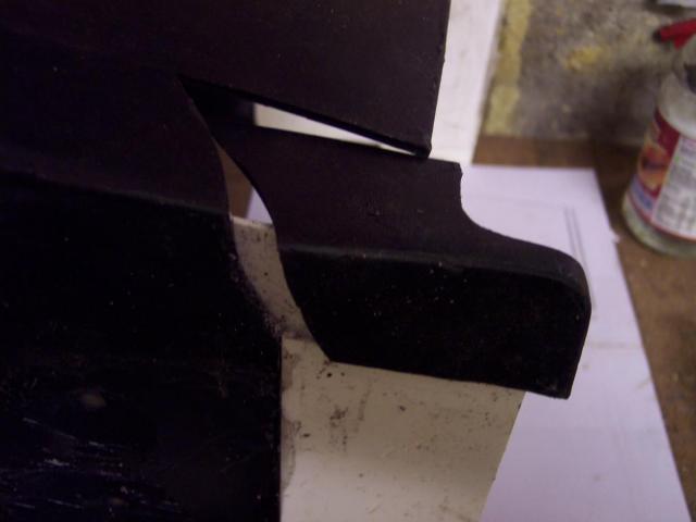

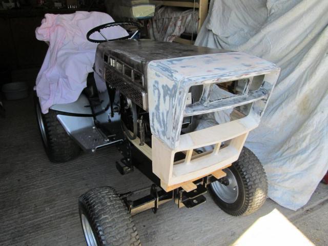

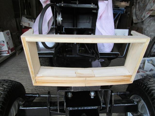

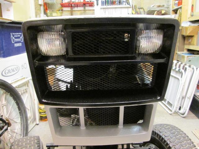

Alan 1,274 #18 Posted January 11, 2016 Now, what to do about the grill assembly, especially the non existent lower section. A few popped up in the US, top and bottom units but all were listed for SS16 tractors. Again most with various damage and high cost with the usual lottery win postage problem. I did contact two sellers asking if the lower SS16 section would fit a GT16. After supplying engine number and other details the reply from both was "Can't be certain". At the time I couldn't see why as both the SS16 and GT16 grills looked similar on various photo's. I wondered if there was a difference with the mounting bolt or hinge pivot positions, neither of which would have mattered due to the non existence of either on my tractor. I now have a good idea why both sellers were unsure, more of this later in the build. So, what now. After studying lots of photo's, both of complete tractors and upper and lower grill sections, it was decided to make my own lower half and repair the damaged top section. Working from a good dead on side view photo found on a US forum and from my damaged top section, I was able to work out the size, width, height, depth and angle of the side panels etc of the lower section. Not to the nearest thou, but close enough to compare with the photo's. Could I make a pattern and mould one in glass fiber as I had done with model boat hulls.? Too much bother compared with a boat hull so that idea was thrown out. If I was to make a pattern why not use the pattern as the finished article. So that's the way I went. Mainly softwood and birch ply glued and screwed together. I started off by repairing the hinge mounting bar of the top grill section bolted and bonded onto the remains of the original. There was just enough left at each end which also gave the correct angle for the new wood mount. Seen in the first photo with the roughed out lower section. The following photo's show various stages of the lower section build. This seemed to take forever with constant checking both on and off the chassis, including cutting out approx 1/2" from the center of the base as the side panels were not quite at the correct angle. The next few photo's are of the almost finished assembly with modified cabinet hinges. These "Might be useful one day" hinges were cut to suit, re drilled and had the fixed pins reduced slightly in diameter so that they could be removed enabling the top section to be lifted off leaving the lower attached to the chassis. Similar to the original units. As said, it took ages getting things to look like the original. Constant assembly and dis assembly, especially with the hinges to get the gap correct between both sections. There are also various angles on the lower section inner faces, not easily seen on the photos. These were determined from the angles of the top section. More to follow. I'm out of breath from all this talking. 6 Stormin, wurzel, pmackellow and 3 others reacted to this Share this post Link to post Share on other sites

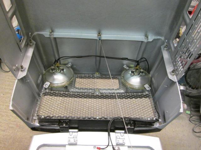

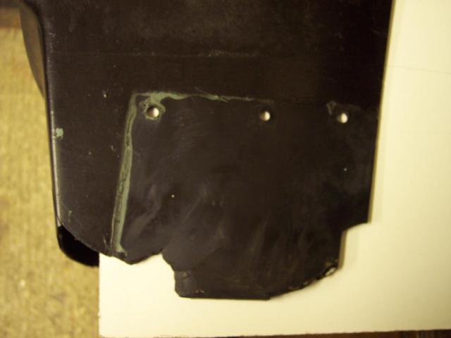

Alan 1,274 #20 Posted January 13, 2016 Thanks Ian. Glad you like. Should have said that before painting, odd gaps in the wood were filled and then the lot sealed with resin which will hopefully keep any damp at bay. The metal hood had various ripples, especially at the front end where it was bolted to the plastic grill. I got most of these out and a bit of filler helped. Not perfect but miles better than it was. A few of the fixing studs had broken loose from the plastic. These were re fixed with Araldite. A small sheet of diamond metal gauze from B & Q was JUST enough with careful cutting to complete the grill along with a pair of lamps from eBay. In hindsight, I could have made the grill from plastic. Next time maybe. When the lower grill was made the engine was not mounted so measurements were taken from the front mounting holes, engine and chassis, the front and underside of the cylinder head cowling etc to make sure that there was clearance. All well and good, until later. A replacement grill mounting bracket was made, constantly checking for correct positioning, height and did it look right on the dash. Yes, it did. Jumping ahead a little, the engine was bolted in, the cyl head cowlings fitted, still good. Until I went to fit the engine side cowling. No clearance between the front of this and the side plate of the lower grill. Bother and other such naughty words. No only was there no clearance but the grill / hood assembly needed to be moved forward by about 3/4". Couldn't work out why at first then the penny dropped. My previous measurements had overlooked that the grill side plate was set back and to the side of the engine cyl cowling. Hope this makes sense. So off came the grill and hood again. The grill was moved forward on the mount and things started looking good again. Even though there was 3/4" difference the hood catches still engaged and a bit more of the dash top showing wasn't too obvious. It was quite a while after this that I found the reason for my mistake. All the photos I had used for reference etc were of tractors fitted with Kohler or Onan engines. I finally came across a photo showing one with a Briggs engine and could see that the left lower grill side plate was NARROWER than the right. The side cowling on the Briggs has almost square corners, the others rounded ends so no need for a shorter end plate. At least that's my reckoning. Probably why the eBay sellers were unsure if their grills would fit. This last photo, from a US forum, shows an Onan engine with the more rounded cowling. 6 the showman, wurzel, pmackellow and 3 others reacted to this Share this post Link to post Share on other sites

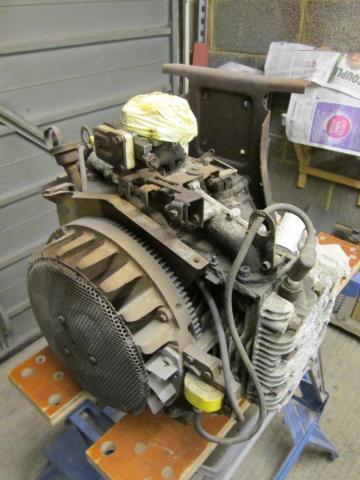

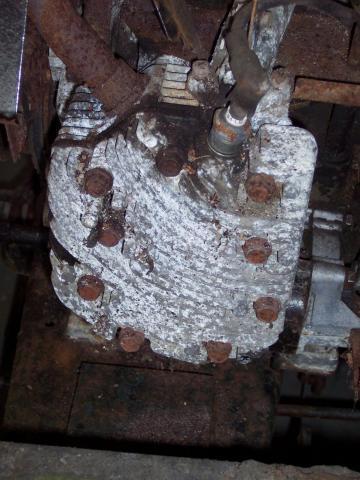

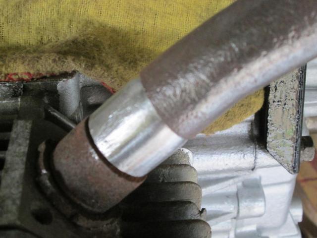

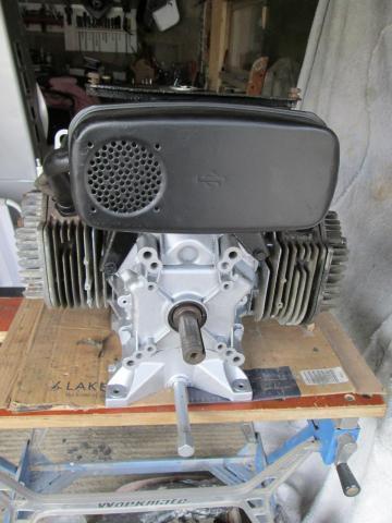

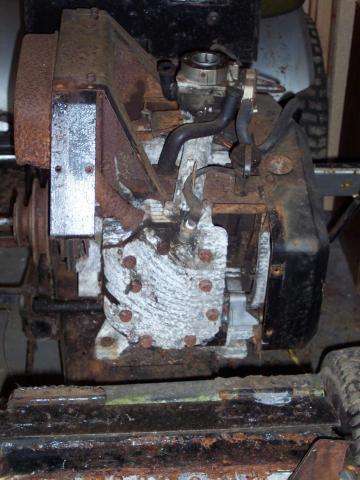

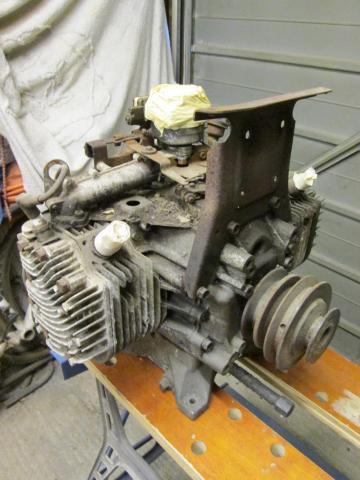

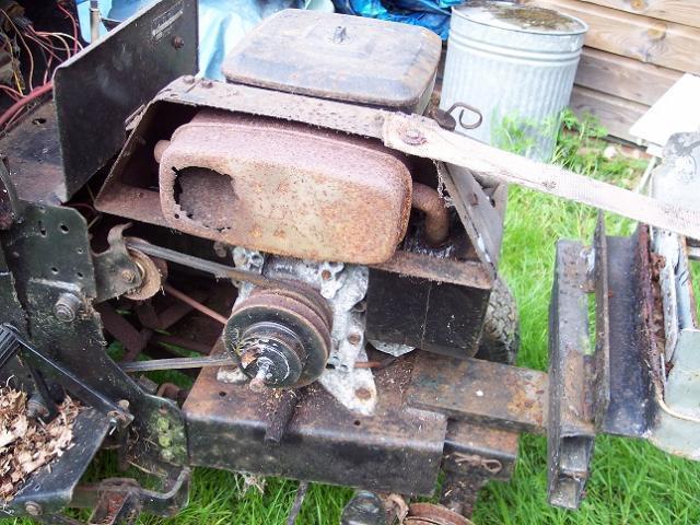

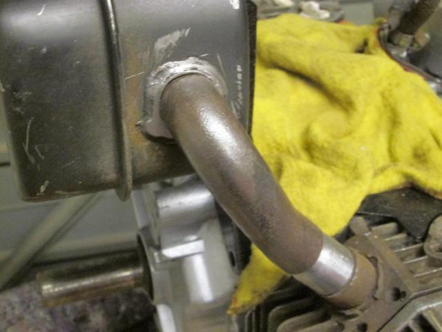

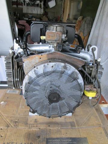

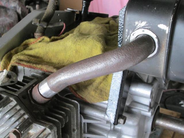

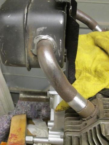

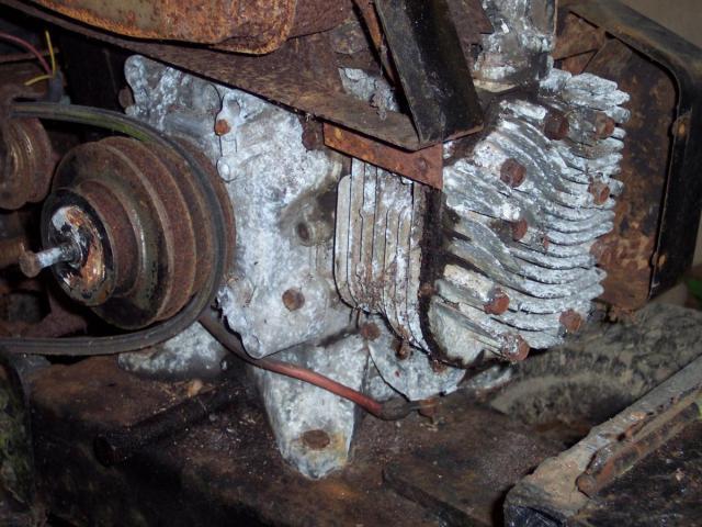

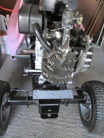

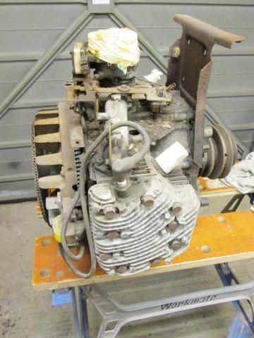

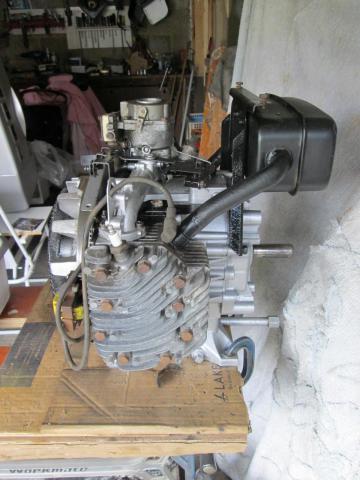

Alan 1,274 #21 Posted January 16, 2016 The engine, when the tin covers were removed, looked a mess. Corrosion and rust everywhere. The outlet of the exhaust box non existent and the internal baffles rattling around. As it appeared to run OK it was decided to just do the minimum to it for now. All the parts which were easily removable, without disturbing too much, were unbolted, cleaned and painted. The corrosion was cleaned from the cylinder heads and crankcase mainly with various size wire brushes. A long and laborious job. The next photo's show the engine during cleaning with some of the bits still to be removed. The exhaust was a big problem. Couldn't find a replacement anywhere for a long time. Then one came up on eBay, listed by a MoM member. The box looked the same but both pipes were of different shapes, length's and distance apart. It was thought this was an almost new unit and had been removed from a different version of the Briggs flat twin. No photo's of the box as it was. The box fitted the mounting bracket perfectly and was the same size as the old, but there was no easy way to connect the pipes to the stubs on the cylinders even using flexible pipe and various other ways I tried. After much head scratching and splinter picking I wondered if I could use the pipes from the old exhaust, which were in fair condition, fitted to the new box. These were cut from the box leaving the internal part of the pipe attached. The pipes were cut from the new box and with a bit of fiddling the old pipes were made to slide in. Another lucky find in my junk pile were parts of a tent frame, or something similar. The stepped plug in ends were found to be a perfect fit to repair the rusted ends of the old pipes where they fitted over the cylinder stubs. Hope this all makes sense. Anyway, more photo's which should hopefully make things clear. After all the bits were ready and fitted to the engine they were tack welded together, by a mate who is miles better at welding than I am, then removed and fully welded up. A quick coat of paint finished the job. 4 Stormin, wurzel, nigel and 1 other reacted to this Share this post Link to post Share on other sites

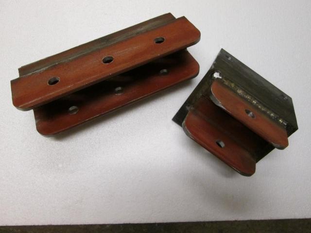

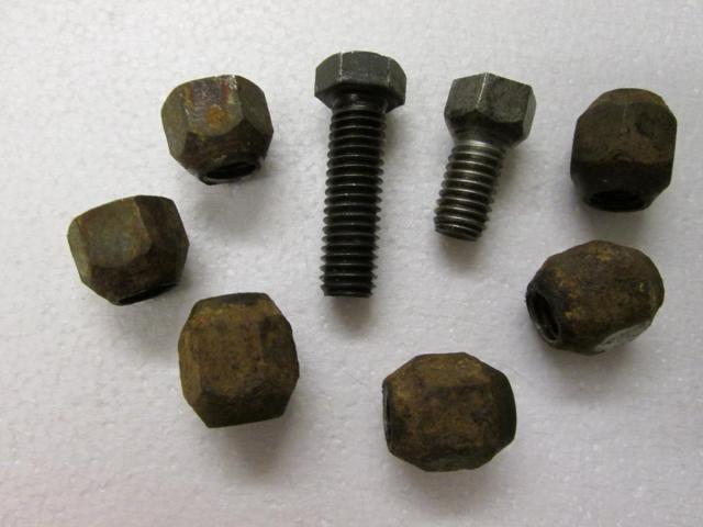

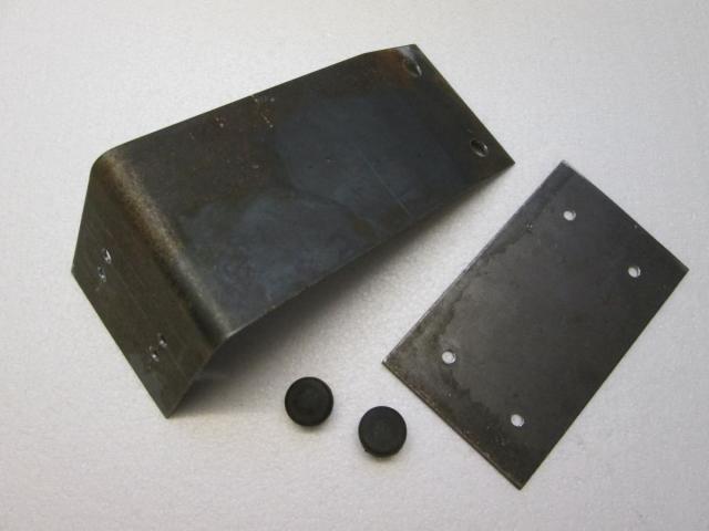

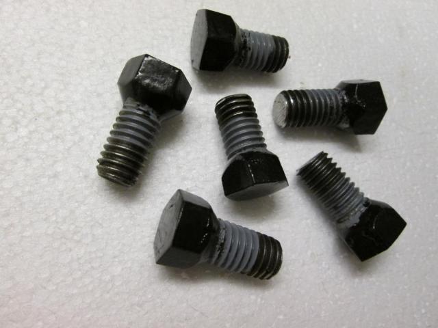

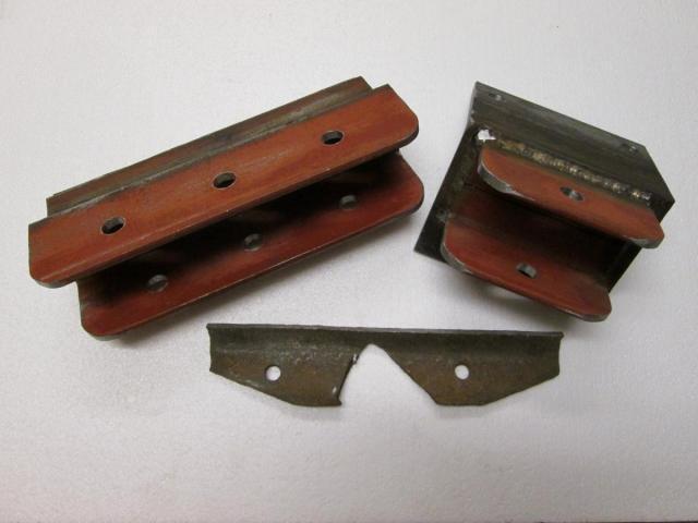

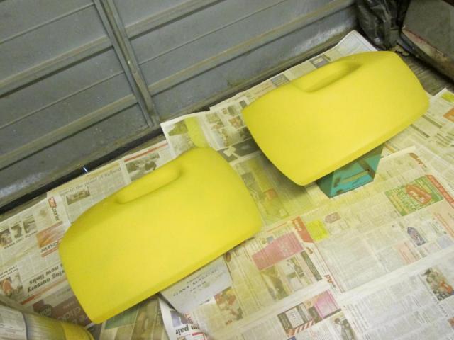

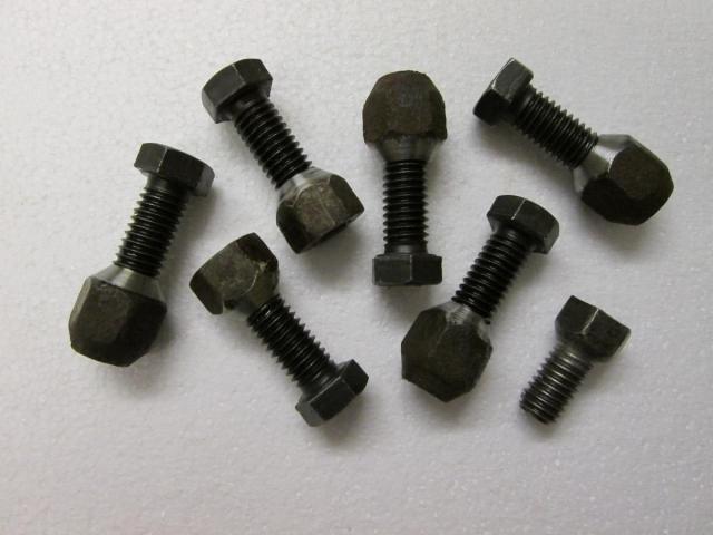

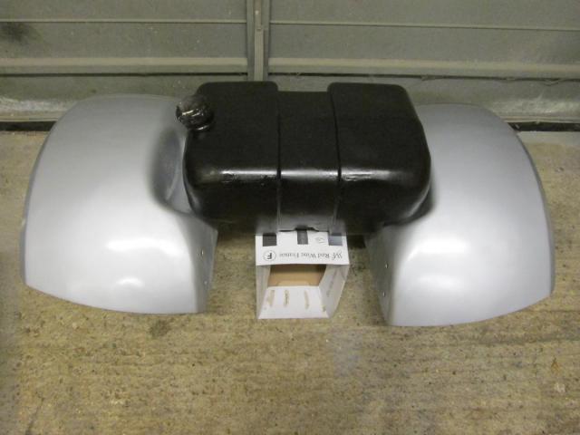

Alan 1,274 #23 Posted January 18, 2016 A few bits and piece's this time. As previously said the tow bar / plate was damaged and cracked. Could have been welded up but a new tow bar was made along with a smaller one for the front of the tractor. These were bolted on. The fuel tank retaining bracket was another missing part. A new one was made up from plate with rubber buffers. Copied as near as possible from photo's. Five of the ten wheel bolts were missing. Again nothing found this side of the pond, and a silly price at the other side. Plenty of 7/16th unf but nothing UNC. If there was I couldn't find any. The heads of standard 7/16th bolts were too thin to machine a cone so these were modified by drilling and tapping old 3/8 unf wheel nuts, from John's place, then fixed to the bolt using lock tight then pinning with dowels. The heads then filed down to match the surviving originals. Would have been quicker to weld, but that's the way I went. Even the seat bracket had been welded up. The seat was in very poor condition. The pan could have been welded up but the padding was too far gone. A Honda seat was obtained from one of John's friends and a modified mounting made up. No close up photo's of this. The last photo's for now are of the wings and fuel tank. 5 wurzel, Stormin, nigel and 2 others reacted to this Share this post Link to post Share on other sites
Stormin 4,458 #24 Posted January 19, 2016 Neat job of the wheel studs, Alan. 2 Alan and the showman reacted to this Share this post Link to post Share on other sites

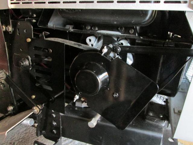

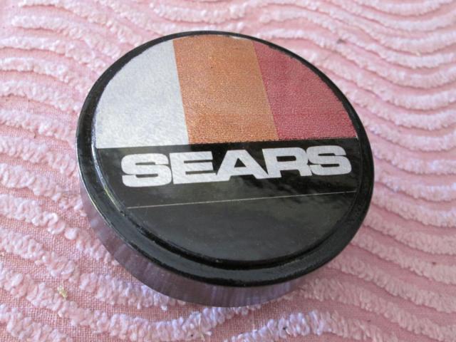

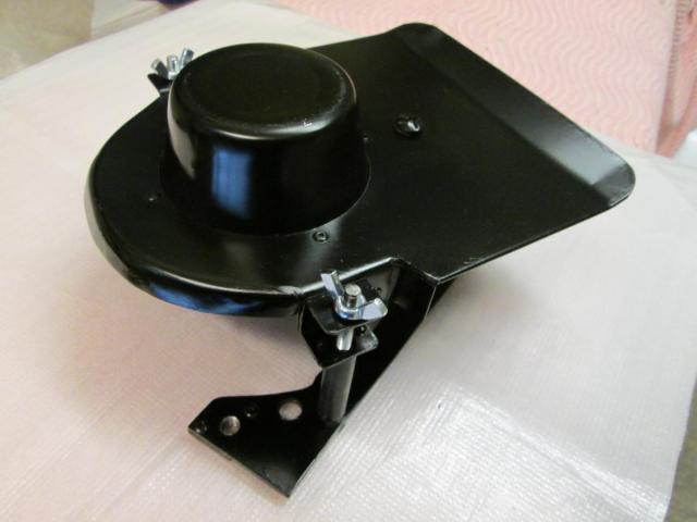

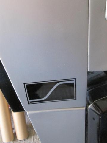

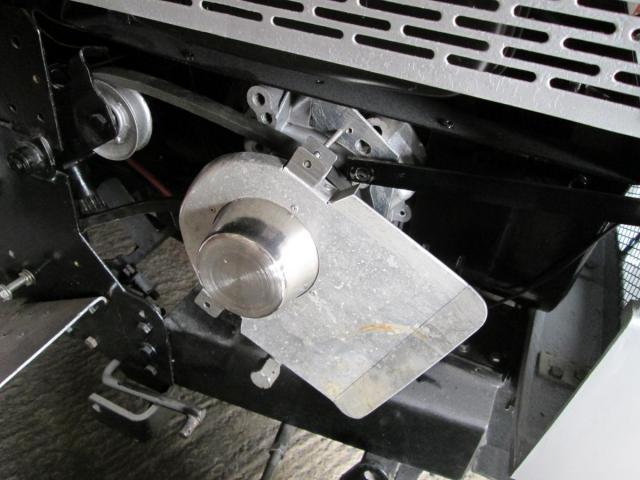

Alan 1,274 #25 Posted January 24, 2016 Also missing, what a surprise, was the belt guard and it's mounting bracket. I estimated the size and shape from photo's and made one up from alloy sheet and a cat food bowl. Not an exact copy but better than the nothing that was there before. The slotted plate, which fits just behind the guard was also made from alloy. Lots of other small parts were either bought or made including the steering wheel center. Most where not recorded or had photo's taken. The decals were made by my son. Difficult to know what exactly was originally fitted as various photo's showed different arrangements so a guess was made. 4 Anglo Traction, Stormin, the showman and 1 other reacted to this Share this post Link to post Share on other sites
