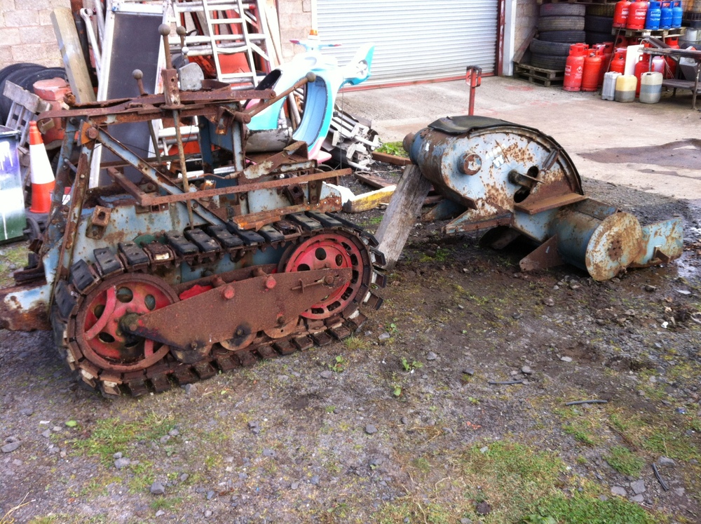

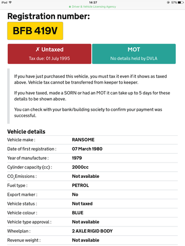

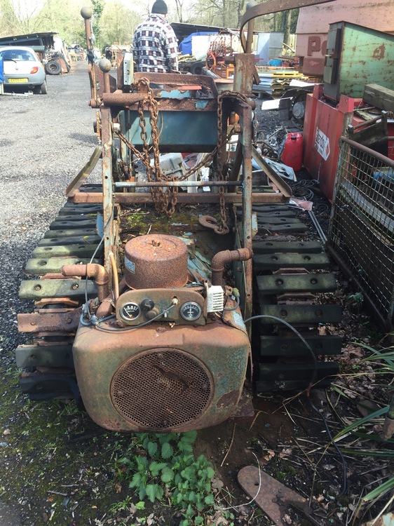

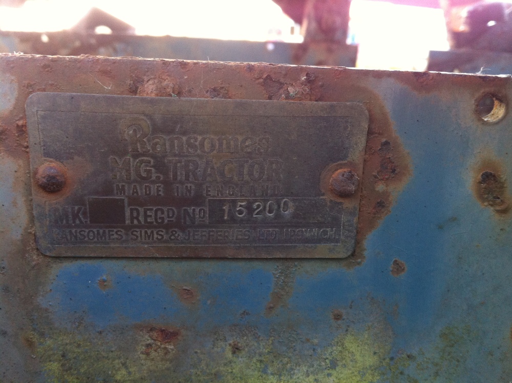

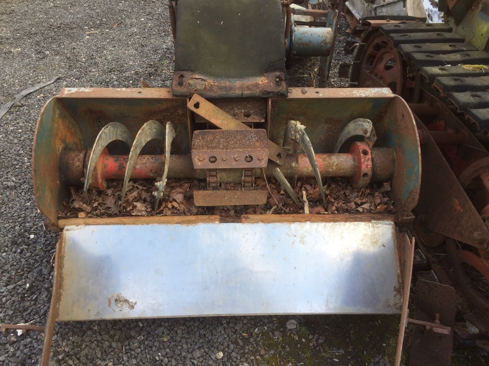

Rocboni 257 #1 Posted May 14, 2016 Thought I better start my own thread regarding the Skimmer. Skimmer SN is 15200 which makes manufacture around about 1965, traced reg number through DVLA hasent revealed much. Main aim is to get it mechanically operational, needs some new steel welding in, mainly sheet metal parts on the top frame where seat is, and engine changed to original Ransomes 600cc. Good thing is it is all there, front auger and conveyor drive roller is free. Its not done much since it was retired as still full of sand, needs a good power wash to flush it all out of engine bay. First job is to free tracks up, get engine off and free up the controls and gear lever. I will get cracking next week but progress is likely to be slow as its being stored 25 miles away while I get the new workshop up. 7 nigel, S1g, Triumph66 and 4 others reacted to this Share this post Link to post Share on other sites

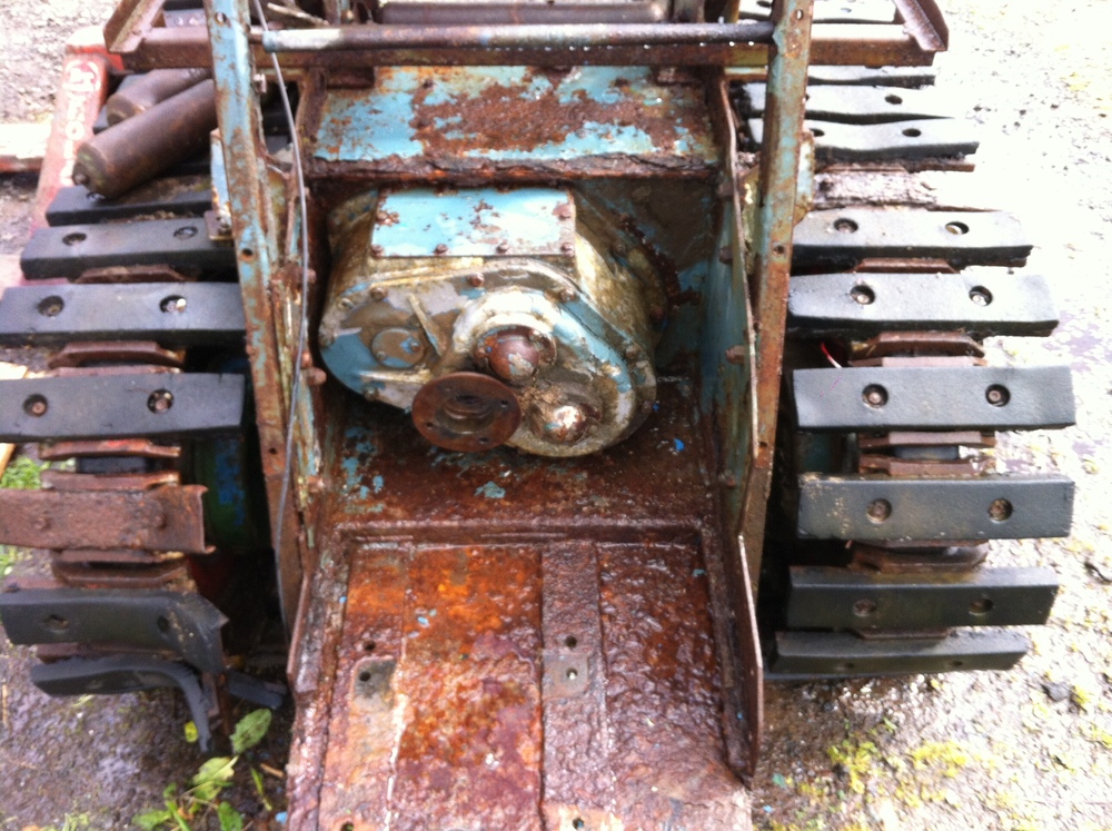

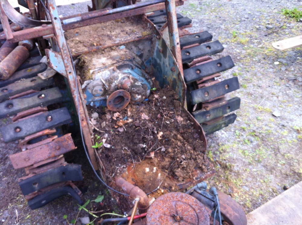

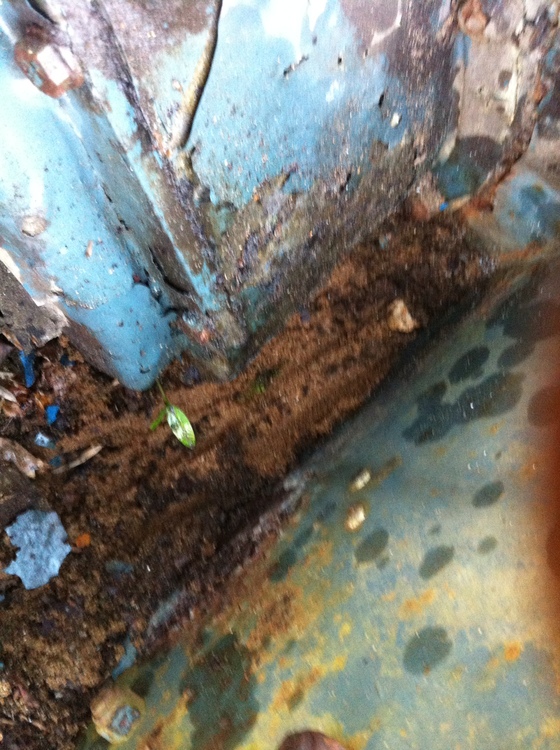

Rocboni 257 #5 Posted May 20, 2016 Taken engine off and washed down the engine bay, sand filled a 25L container! Input flange bearing is shot and engine bay floor looks like it has been dropped to accommodate Kohler engine. 7 Triumph66, nigel, diggerjames and 4 others reacted to this Share this post Link to post Share on other sites

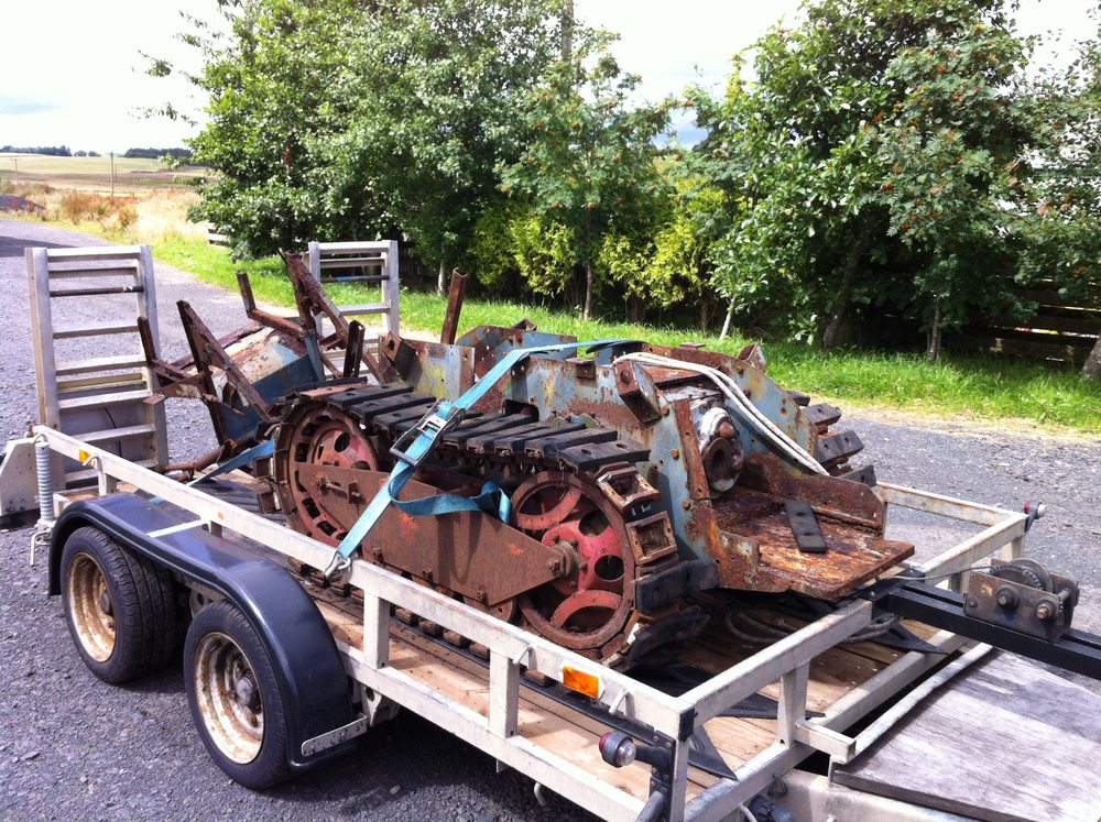

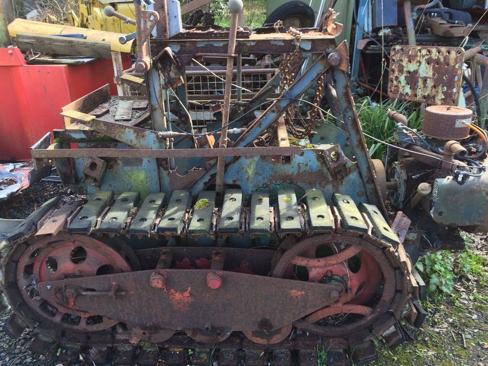

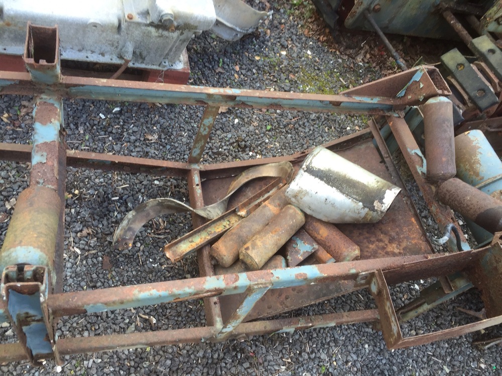

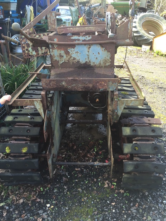

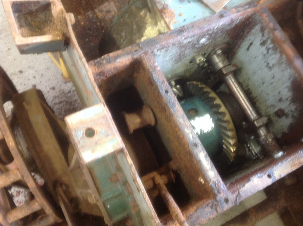

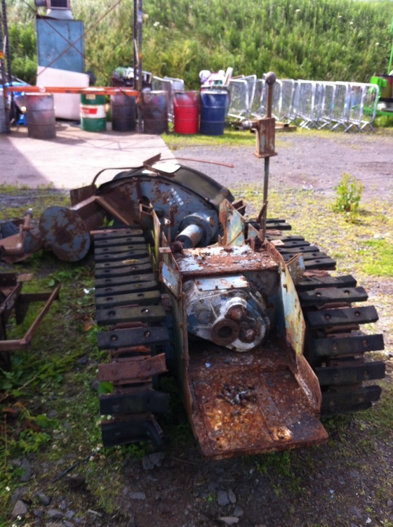

Rocboni 257 #12 Posted July 16, 2016 Went this morning to see if I can get it rolling, no luck unfortunately. One track appears free, forward and reverse lever is free and so is the 3 speed gearbox so I can get it into gear. Need to get the top off the dif casing to get to brake bands but bolts have no heads and need cut off and I had no acces to power today. I removed the top frame to improve access to both tractor and frame as I need to re weld the roller carriers which had been cut out with agas axe for some reason but I have the bits. Just need it rolling so I can winch onto trailer and get it home, once home I will strip, clean and reassemble. 1 nigel reacted to this Share this post Link to post Share on other sites

Rocboni 257 #14 Posted July 16, 2016 I hope the engine doesn't turn out to be as bad as the tractor is, the metal is de laminating in places especially the diff/brake band cover, I am able to renee this all together though as well as engine bay floor. Share this post Link to post Share on other sites

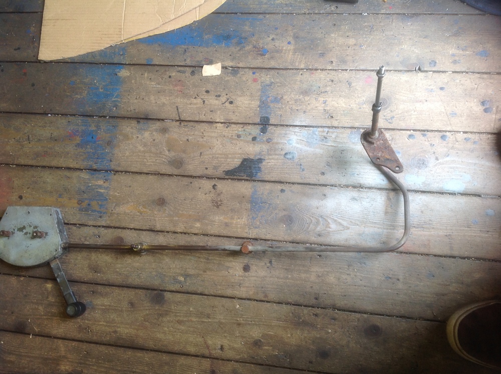

Rocboni 257 #15 Posted July 17, 2016 This is the 3 speed gear lever, the arrangement is quite different to Jonathan's 2 as this is a formed solid brass tube neatly dressed to the skimmer frame rather than a flexible cable, it was a bit stiff so I've been freeing it up this morning, you are not able to remove the inner flexible cable however it has a grease nipple clamped to the tube, so I pumped grease into it until fresh grease was visible at each end and kept on working the lever, it now works well. Share this post Link to post Share on other sites

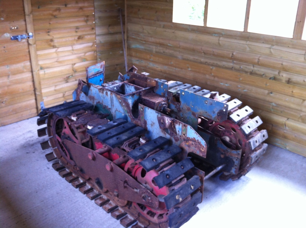

Rocboni 257 #16 Posted July 29, 2016 Well after a lot of blood sweat and tears literally, it is free and now that my mum and dad are on holiday for 2 weeks I thought it was a good time to drag it home and get it in the shed, everything is a lot harder when you by yourself! I am also on holiday for 2 weeks so will be making a start in between making all my meals! 1 S1g reacted to this Share this post Link to post Share on other sites

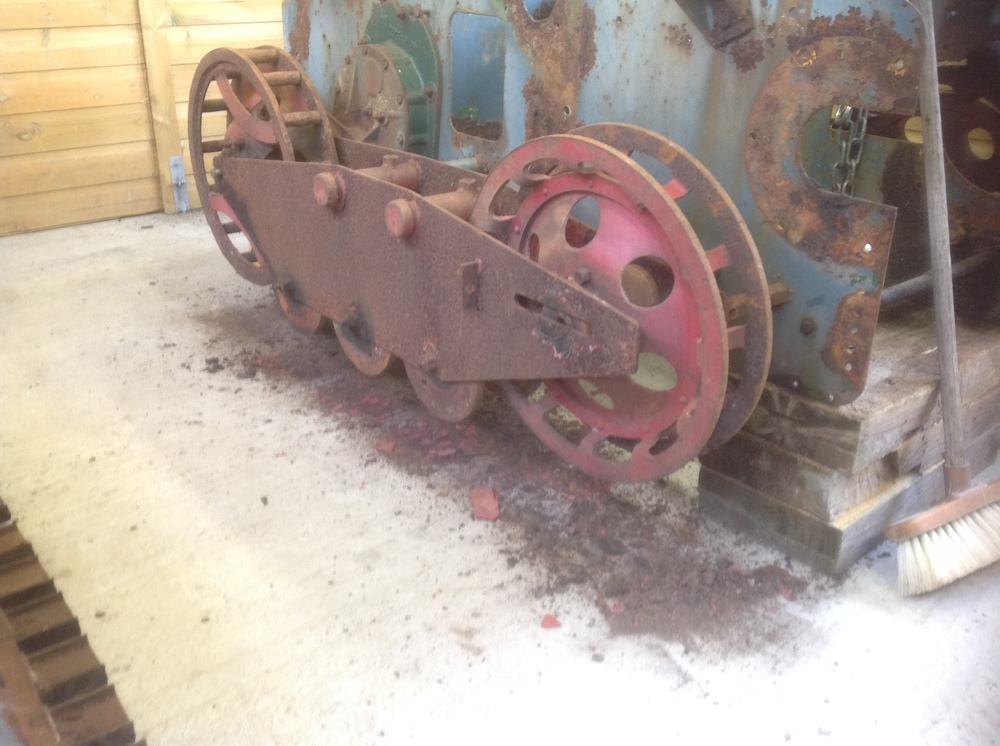

Rocboni 257 #17 Posted July 29, 2016 Track off ready to remove side frame to replace brake drum, started scraping all the loose rust off, will probably go over it with a wire brush and leave it at that. Some bolts do not even resemble a bolt just a mound of rust! 3 S1g, Alan and nigel reacted to this Share this post Link to post Share on other sites

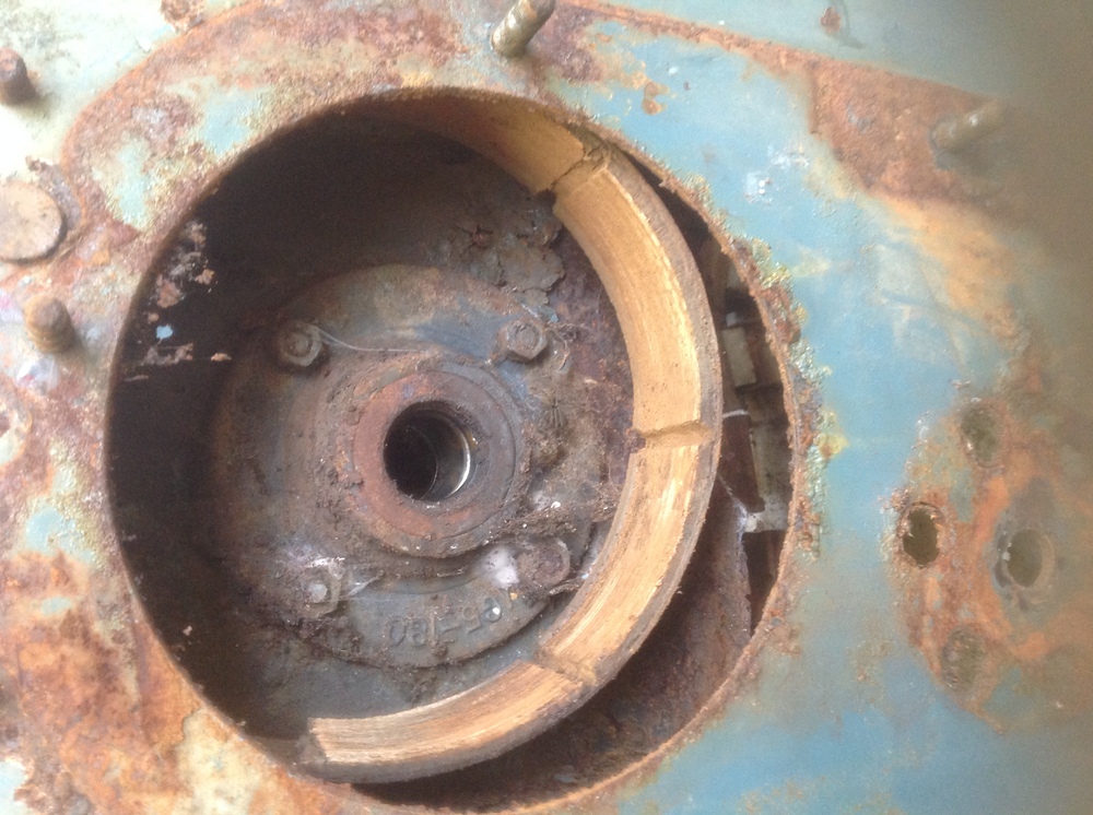

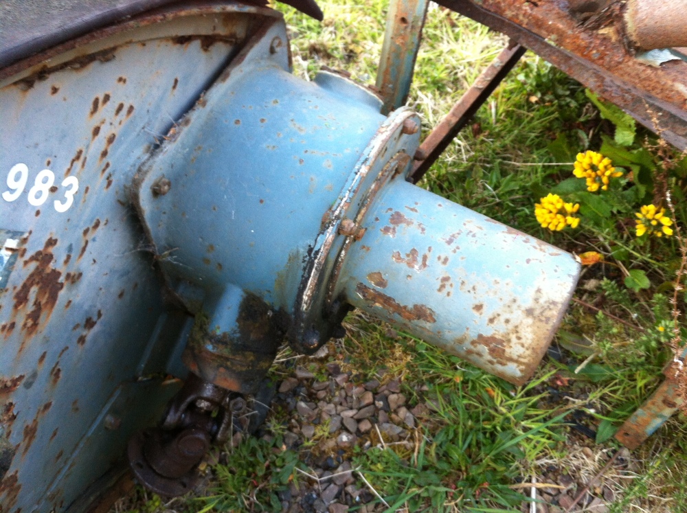

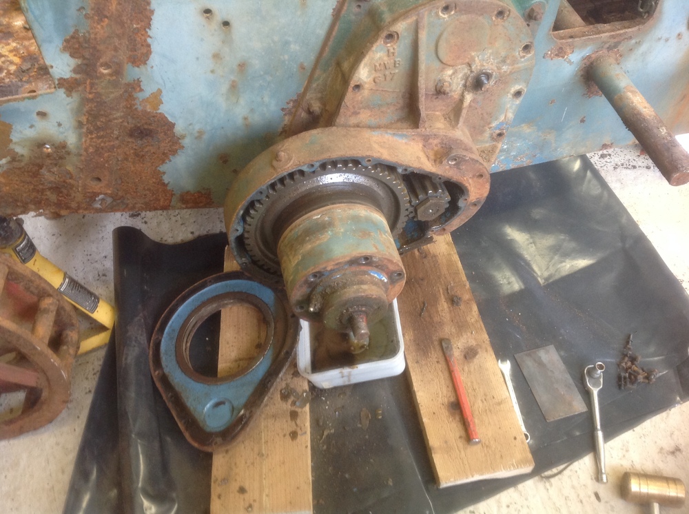

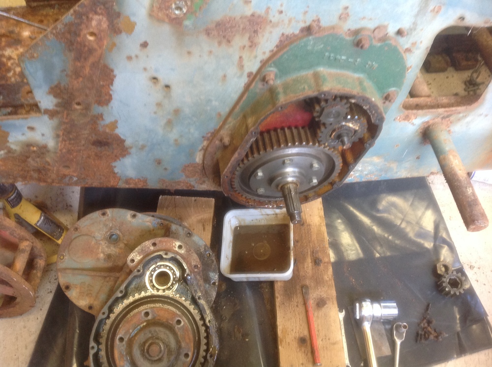

Rocboni 257 #20 Posted July 30, 2016 Close up on the final drives, this is the key to the slow speed of the skimmer, underneath the second case is a set of the same gears, usually this is where a normal crawler bolts it wheels but the skimmer has extra gearing. 2 Stormin and nigel reacted to this Share this post Link to post Share on other sites

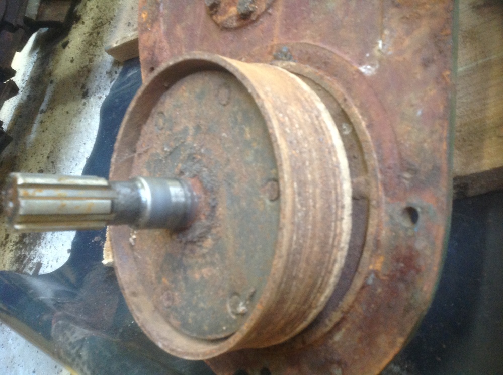

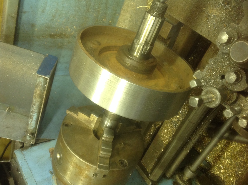

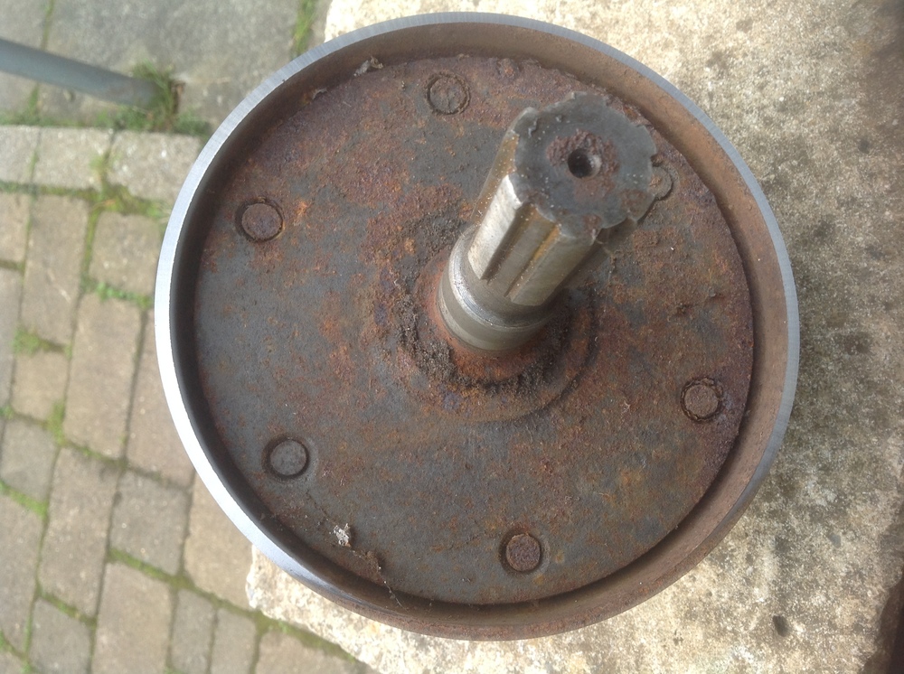

Rocboni 257 #21 Posted July 30, 2016 All that work to to get to this! Brake drum not as worn as I originally though but will still replace it, this was the side which the brake would always be applied to turn in the pit. 1 Stormin reacted to this Share this post Link to post Share on other sites
Rocboni 257 #22 Posted July 30, 2016 I have recently been informed by a fellow collector Alastar Holt that this machine is one of a pair originally supplied to the South Essex Waterworks Co. On the 7/3/1966 According to the royalty legend there were about 76 skimmers but I'm not sure if this includes every machine. 1 Stormin reacted to this Share this post Link to post Share on other sites

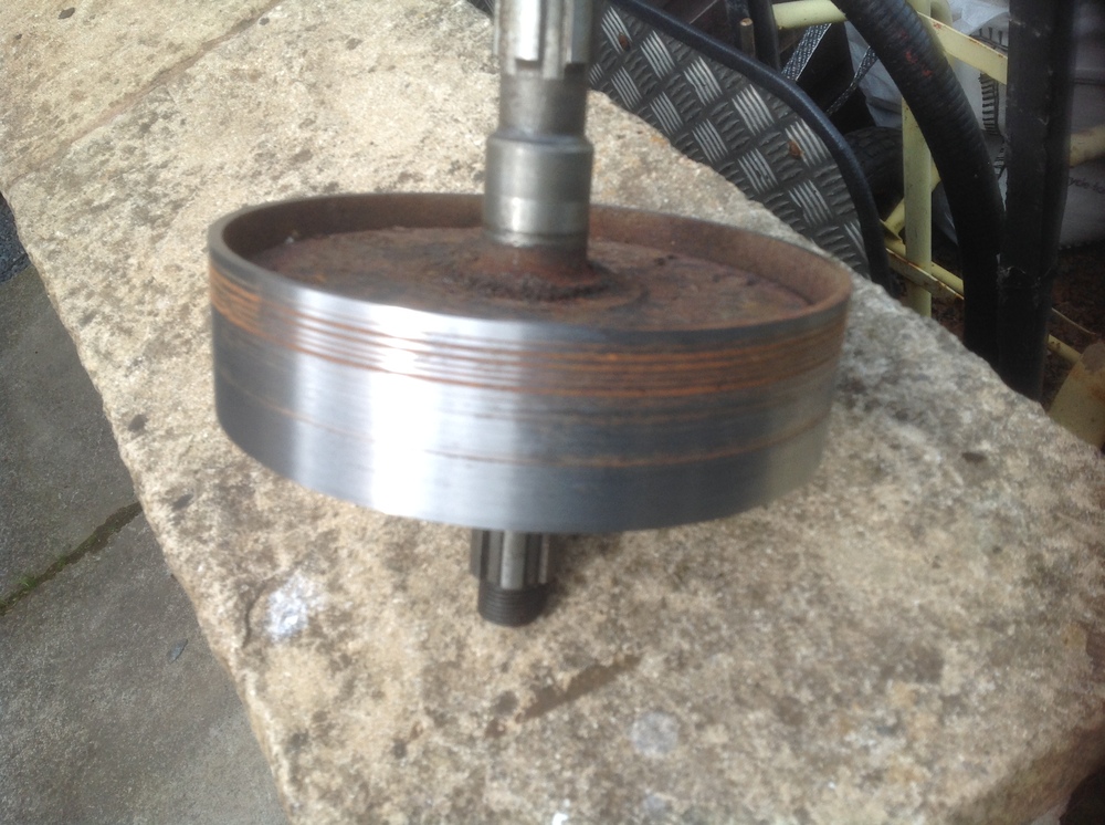

Rocboni 257 #23 Posted July 30, 2016 Good brake drum skimmed Share this post Link to post Share on other sites
Stormin 4,458 #24 Posted July 30, 2016 Good to have some history, Rhys. Share this post Link to post Share on other sites
Rocboni 257 #25 Posted July 31, 2016 I skimmed the worn drum and it still looks ok so may re fit it. 2 nigel and Stormin reacted to this Share this post Link to post Share on other sites
