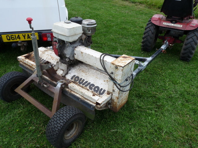

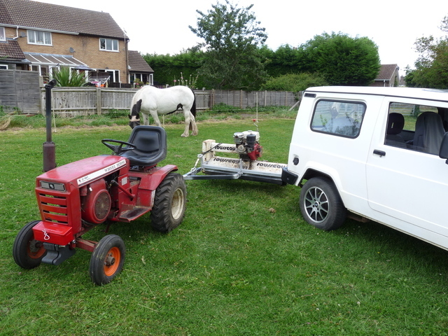

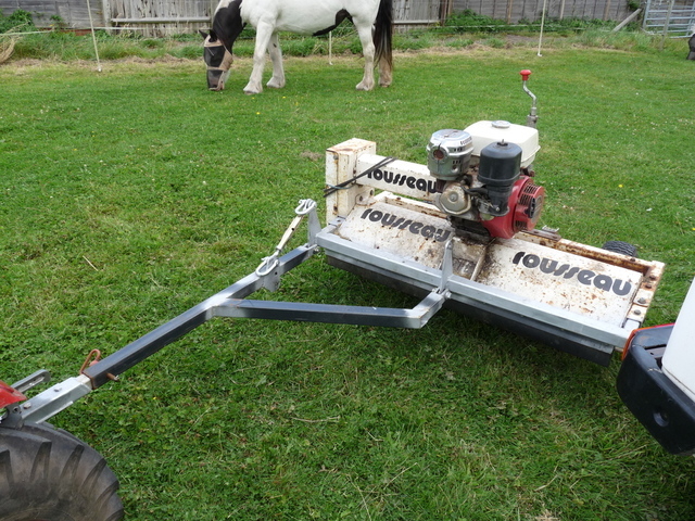

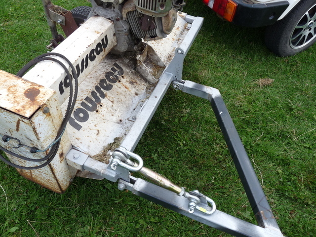

ranger 373 #12 Posted September 13, 2016 Great bit of kit My version of this involves a quad, front mounted flail mower with castor wheels on the front, I added an adjustable pair of wheels at the rear, and towed it round to cut the paddocks. I've now modified it again by cutting off the castors and adding a towbar which flips over for centre or offset towing. First pic shows the four wheeled version. 2 4x4forks and Triumph66 reacted to this Share this post Link to post Share on other sites
