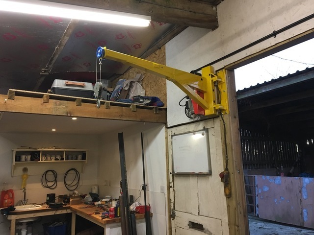

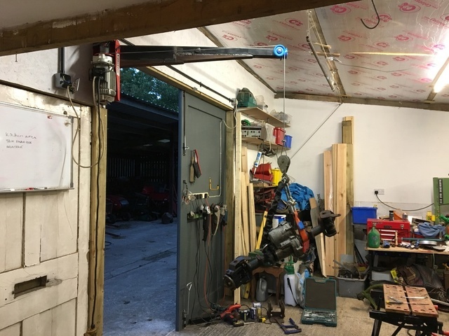

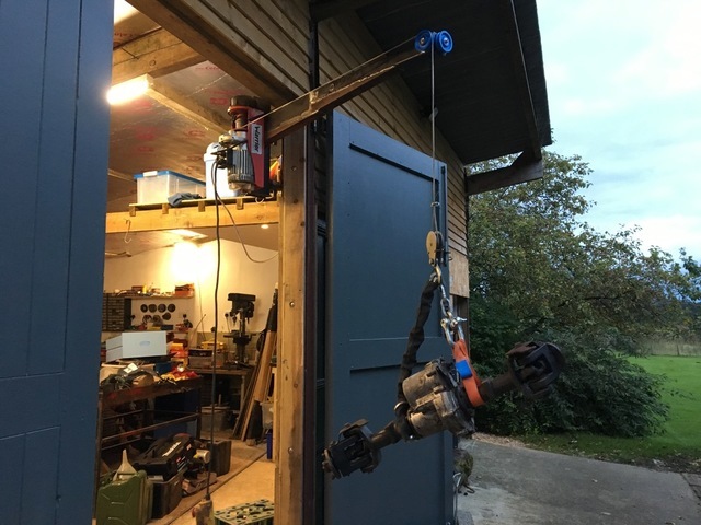

meadowfield 1,901 #1 Posted October 8, 2016 I'm not getting any younger and everything I work on gets heavier.... picked this up the other week for £30 and with some recycling of an old American bike rack that was built like a tank. Ive got this A handy crane with a 4ft boom that swings inside the workshop 10 Anglo Traction, Ian, Triumph66 and 7 others reacted to this Share this post Link to post Share on other sites

HeadExam 1,783 #3 Posted October 9, 2016 superb idea and fabrication. Share this post Link to post Share on other sites
Ian 2,417 #4 Posted October 9, 2016 That's a great idea Mark, it should save your back a bit Share this post Link to post Share on other sites
Anglo Traction 1,022 #5 Posted October 9, 2016 Very Handy peice of gear Mark...... Have you established as 'SWL' limit for it?. Share this post Link to post Share on other sites
Stormin 4,458 #6 Posted October 9, 2016 19 minutes ago, Anglo Traction said: Very Handy peice of gear Mark...... Have you established as 'SWL' limit for it?. When it comes off the wall, that's it limit. 1 Alan reacted to this Share this post Link to post Share on other sites

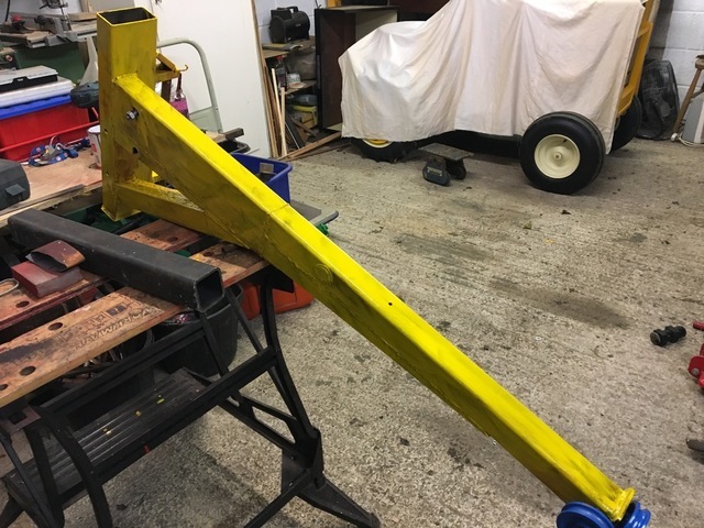

meadowfield 1,901 #7 Posted November 13, 2016 Found time to give it a lick of paint Share this post Link to post Share on other sites

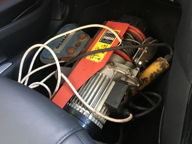

Mister Mad Mower 64 #14 Posted November 22, 2016 I got my scaffold winch from Netto , around 10 or so years ago .Every winter it goes in the boot of the car with a 18" length of 1" steel bar . It works a treat off one of the inverters ( 1200w ) and gives me enough pull to get out of trouble . Cut out the tow ball profile in the back plate with my little Cebora plasma cutter . It sits snuggly around the towing ball and the 1" bar is slid through the scaffold pole clamps to clamp the motor to the neck of the ball, quick and easy winch . Plus i can use it as intened if the need arises . 2 slf-uk and ranger reacted to this Share this post Link to post Share on other sites
meadowfield 1,901 #15 Posted November 27, 2016 Added last coat of paint, 10m of new stainless cable and I'm done. Ready for use 3 Alan, Cub Cadet and nigel reacted to this Share this post Link to post Share on other sites
