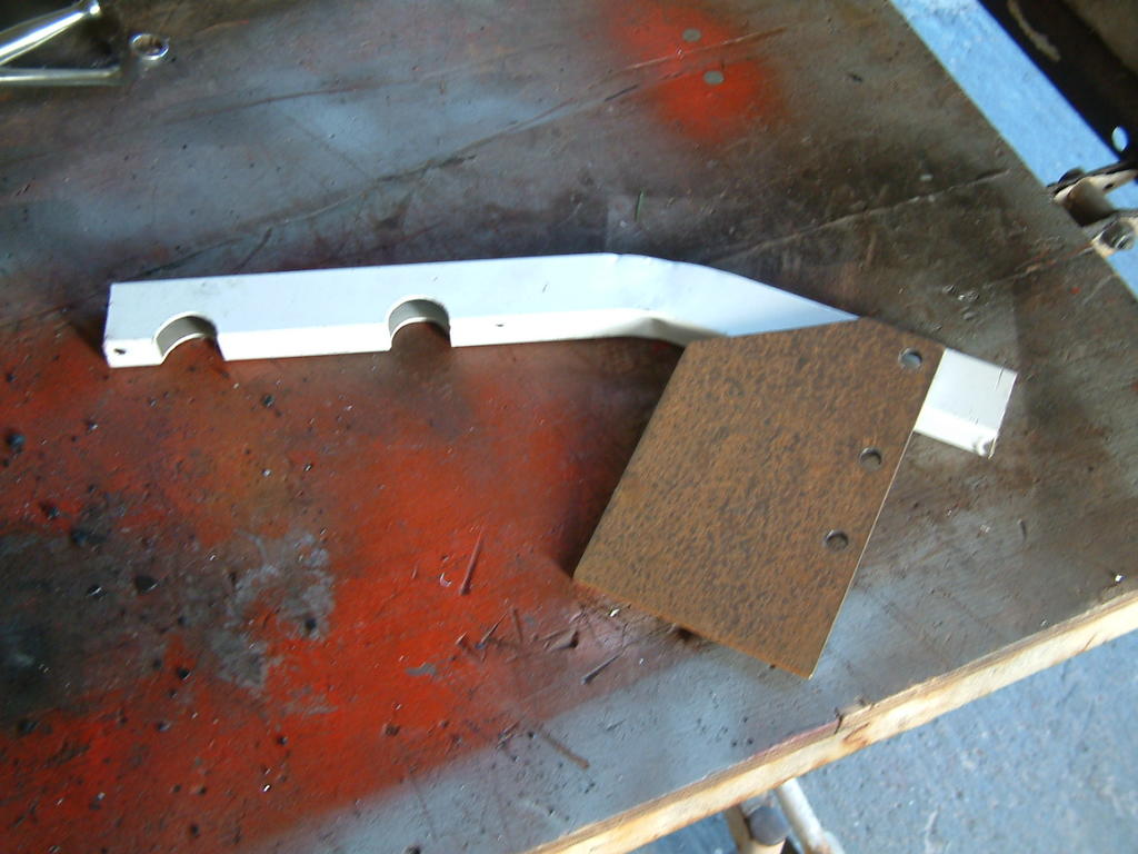

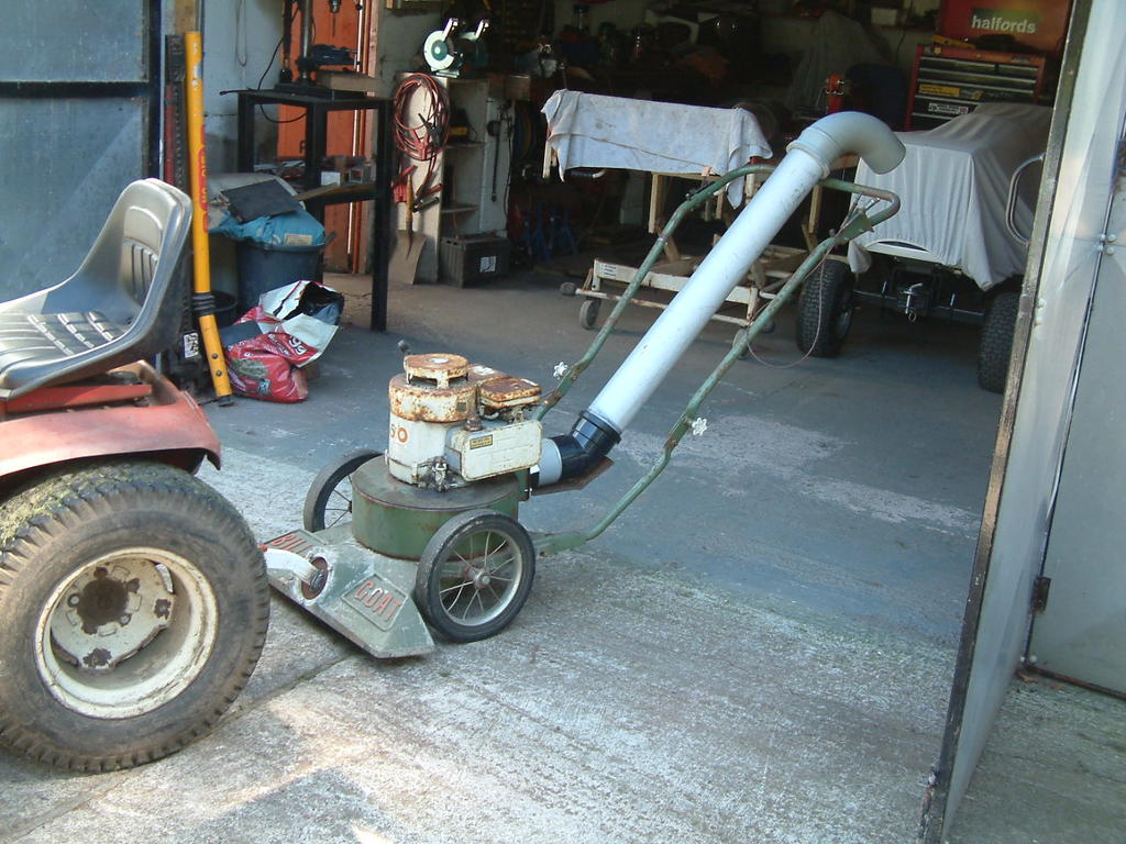

Stormin 4,458 #1 Posted July 8, 2017 Last year on my annual trip down south, one of the things I returned with was this Billy Goat. There is a thread on it in Pedestrian machines. As you can see I'd been having a bit of a play with it. Today I dug it out of it's hiding place had more of a play with it. First I amputated it's back legs wheels. I then found these two pieces of scrap, plus the jaw plates removed from my Saxon trailer. They became this towing attachment for the front of the Billy Goat. Next job was a rear towing attachment. A length of 1"x1". Another of 1"x2". A couple of U bolts. Tow ball plus a spare spacer and I had this. At end of play this is how things look. There's still more to do and one or two alterations but so far so good. All made from scrap lying around, so zero cost. No Billy Goats were harmed and if needs be can be put back as was. To be continued......... 8 1 Westie1, S1g, pmackellow and 6 others reacted to this Share this post Link to post Share on other sites

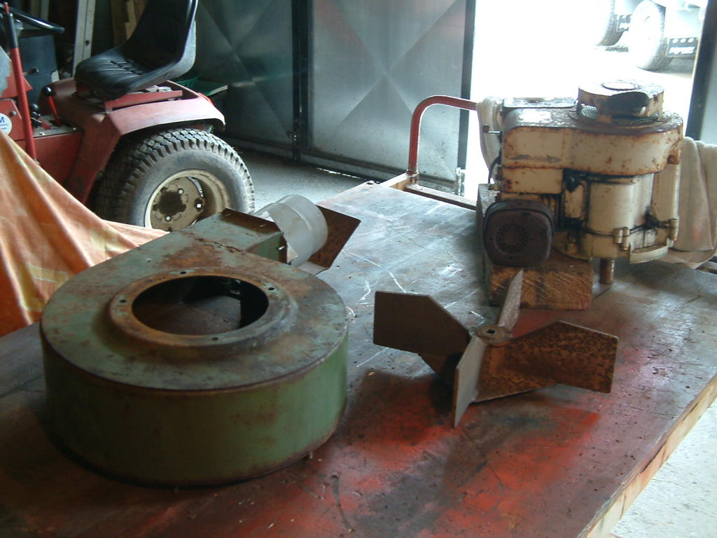

Stormin 4,458 #12 Posted July 15, 2017 Today I decided to remove blower housing body and engine from the chassis. Body and engine taken of with to much of a problem though rather fiddly. Pleased to say the all the nuts came undone easily. Next split engine from blower housing. Again all nuts and bolts undid freely. This was when I realised that the blower fan wouldn't come out of the housing while attached to the engine. Again luck smiled down and the bolt securing fan to engine came loose with no trouble. To get fan off the shaft was another thing. Had to tip the assembly nearly on it's side. Just enough to get a puller on the fan and not to much that engine oil leaked out. Holding the puller onto the head of a long bolt that fitted down the bolt hole in the shaft, steadying the whole assembly and using a ratchet and socket, was a bit of a juggling job. Thankfully the fan came away trouble free. Below is how things look now. The reason I've taken everything apart, is my idea of turning the housing round on the chassis and engine round on the blower housing., as mentioned earlier. Two snags now reared their heads. First a rubber vibration absorbing gasket is fitted 'tween engine and housing. This was perished and came away in bits. Secondly the engine mounting holes are not drilled equally on the p.c.d. To be continued......... 3 S1g, Alan and Cub Cadet reacted to this Share this post Link to post Share on other sites

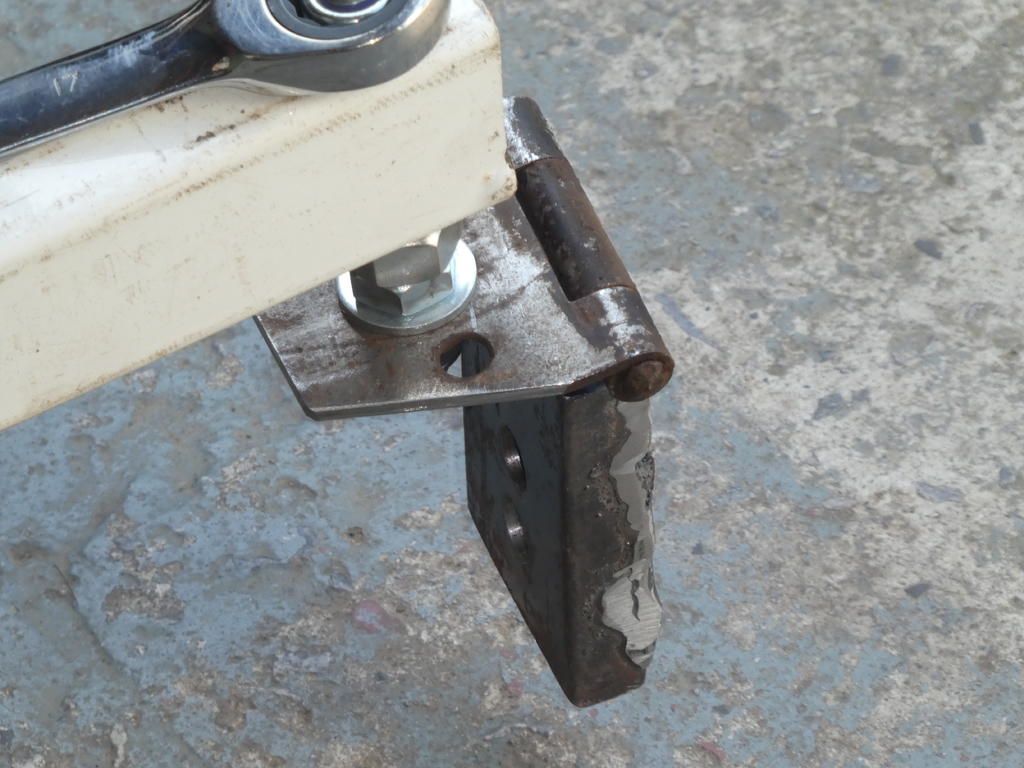

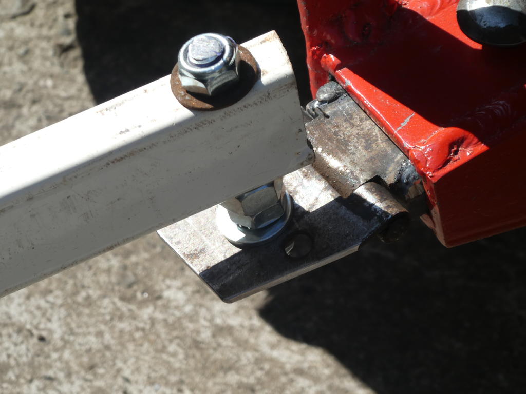

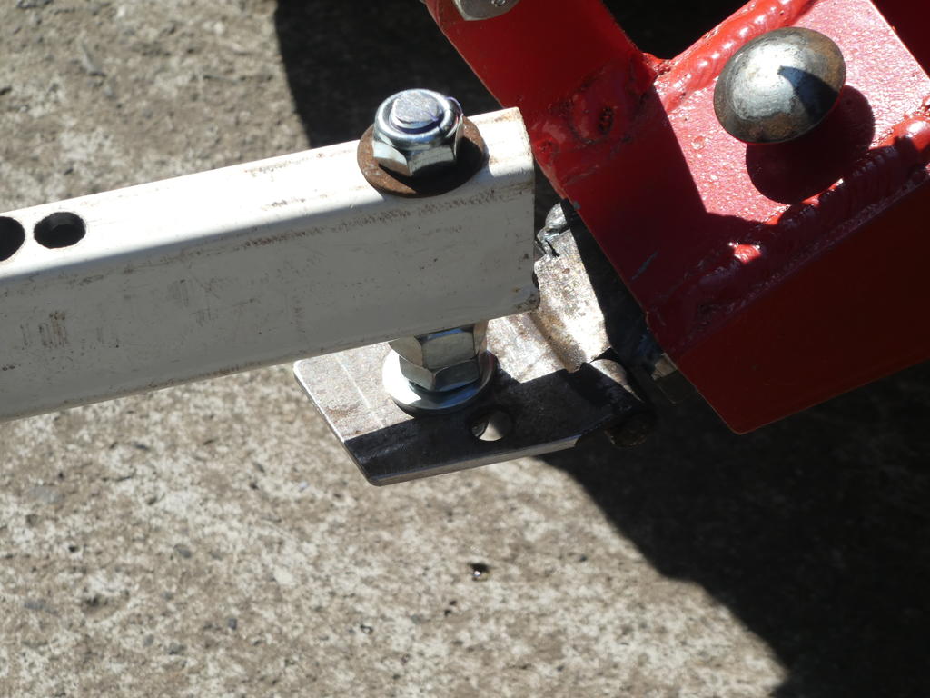

Stormin 4,458 #13 Posted July 6, 2019 Today I thought I'd better do something about the Billy Goat. So I dragged it out from it's hiding place and placed it behind the C-125. After much thinking, swapping and general trying to work something out, the C-125 was fitted with a slot hitch. The front wheels removed from the Billy Goat and a coupling knocked up. Tried various things, none of which I was happy with. Suddenly I had a flash of inspiration. How would a hinged coupling work out. So with no more todo, I knocked one up using a cut down butt hinge. See below. Up! Down! The principle works and I can adjust the Billy Goats intake height with the lift levers adjuster. I think this could be a suck it and see project. I already have some alterations in mind. I'll post some photo's of it coupled up tomorrow all being well. 3 slf-uk, Alan and Cub Cadet reacted to this Share this post Link to post Share on other sites
Stormin 4,458 #14 Posted July 7, 2019 Raised and 2-1/2" ground clearance. Lowered. To be continued...…. 3 Alan, Cub Cadet and Anglo Traction reacted to this Share this post Link to post Share on other sites

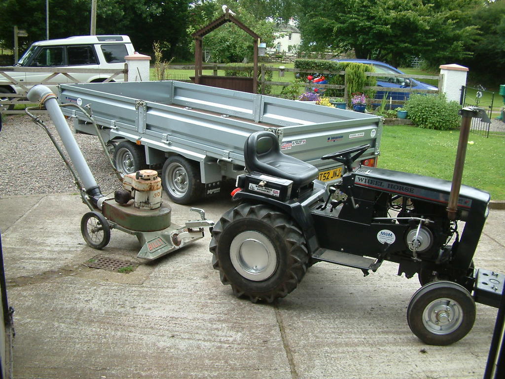

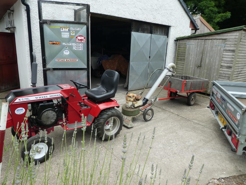

Stormin 4,458 #15 Posted July 8, 2019 Hooked things up this morning to see how things looked. Fired up the Goat and threw a latex glove under it. Shot it nicely in to the back of the trailer. Also blew it out again. By 'eck it's got some waft. So what next. Need something along the lines of a silage trailer, methinks. So what's next? To be continued...….. 3 Triumph66, Cub Cadet and Alan reacted to this Share this post Link to post Share on other sites

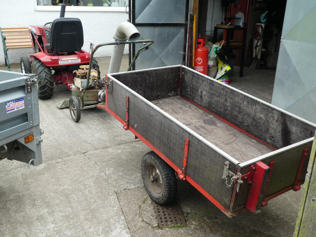

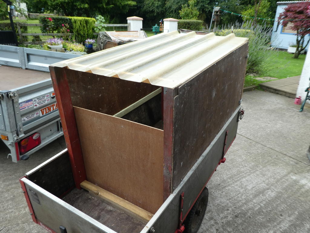

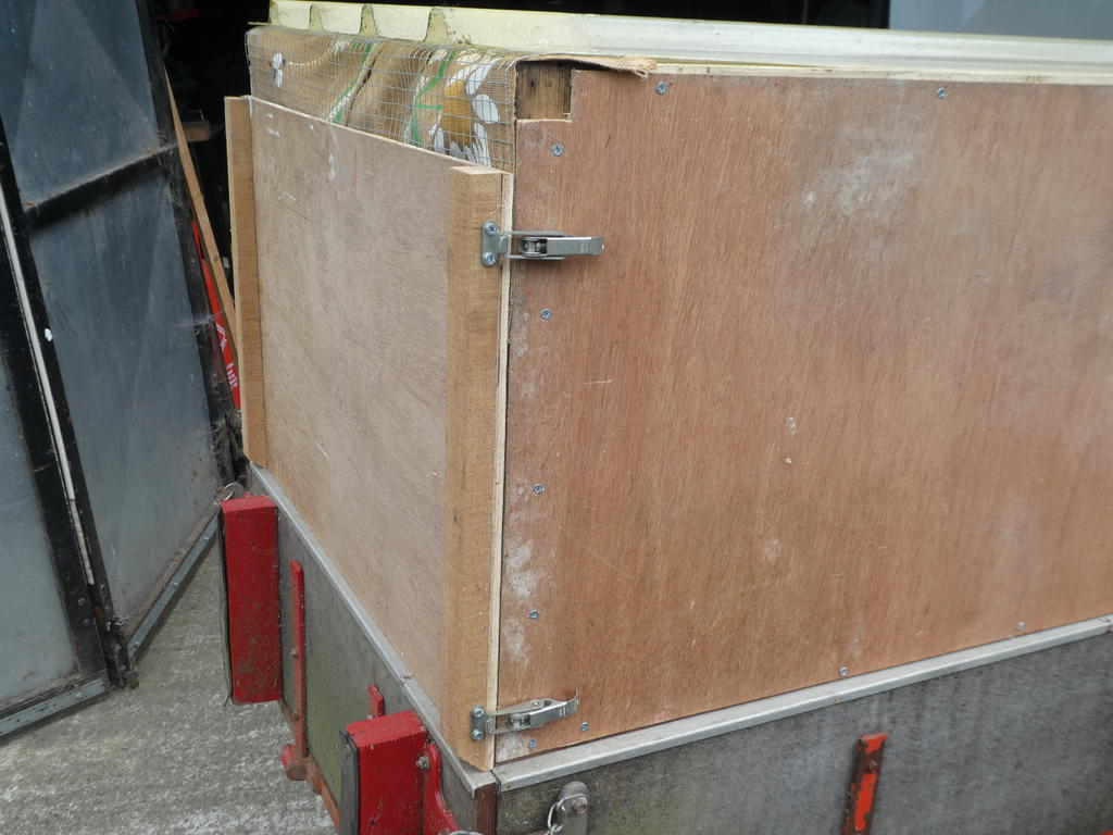

Stormin 4,458 #21 Posted July 18, 2019 Had another play with the suck it and see project. Modified the hitch, Billy Goat to tractor. Made it offset so the Goat is about 3" to the left of the tractor. This is so the tractor exhaust is clear of any hedge or tree low branches. Even threw some paint at it. Last week I did some work on sides and top for the Saxon trailer. All made out of scrap material I had lying about and also some of a neighbours. Everything can be dismantled in a few minutes. Yes! The sides are a bit short, but that is because the scrap ply was that length. At the rear, the back is held by the clips you see. The chamfers at the bottom allow the tailboard to open. To stop, (hopefully) grass/leaves being blown out, but let air through, a wire mesh covers the gap with hessian behind it. The hessian is a cut up shopping bag, that Carol was going to put in the rubbish bin. The vertical edges being trapped twixt end panel and side Next I'm going to have to spend some cash and buy a flexible hose 4" pipe. Still, shouldn't complain as expense so far has been zilch. 3 Cub Cadet, nigel and Alan reacted to this Share this post Link to post Share on other sites

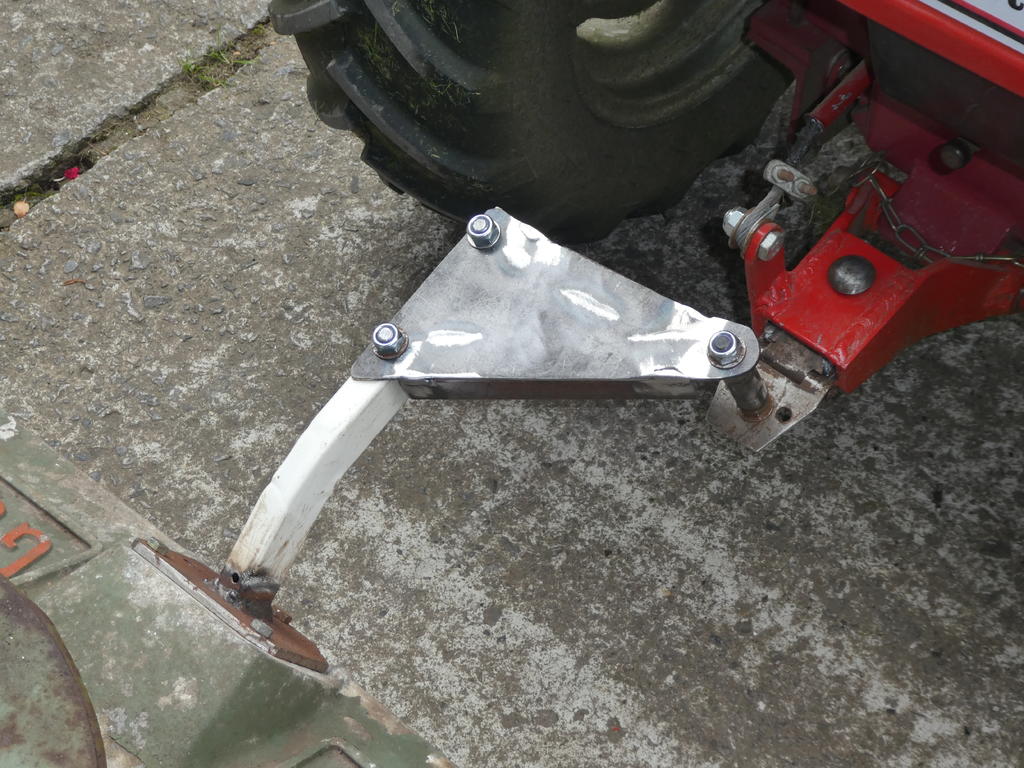

Stormin 4,458 #24 Posted July 6, 2020 Been a little while, but I thought it was time I knocked the dust of this little project. Towing the Billy Goat and trailer, due to the nature of the ground I mow, was always going to be rather awkward. So I've been thinking of a slightly different idea. Made a start yesterday and the Billy Goat ended up like this. Now I don't want to make any alterations to the Billy Goat. If this idea doesn't work, I want to put it back as was. Some head scratching and ratching about to see what was lying around, I've ended up with this. The side bars are the second pair. The first ones I made I decided were too short. To be continued...…. 2 Triumph66 and Alan reacted to this Share this post Link to post Share on other sites
Stormin 4,458 #25 Posted July 7, 2020 Bit more done this afternoon. Trailer towing attachment done. Just needs tow ball fitted. Frame work for the drawbar. Lucky I found the U clamps. The bar had to go there to clear the casting. Couldn't bolt it on as no room to get a nut on underneath. Only just managed to get the U clamp nuts on. Might not look much, but much putting on and taking off done. I need it off the bench now and behind a tractor. Then I can work out draw bar position, height etc. I'll have to wait till one of the grandsons visit to give me a hand. 3 expeatfarmer, Triumph66 and nigel reacted to this Share this post Link to post Share on other sites
