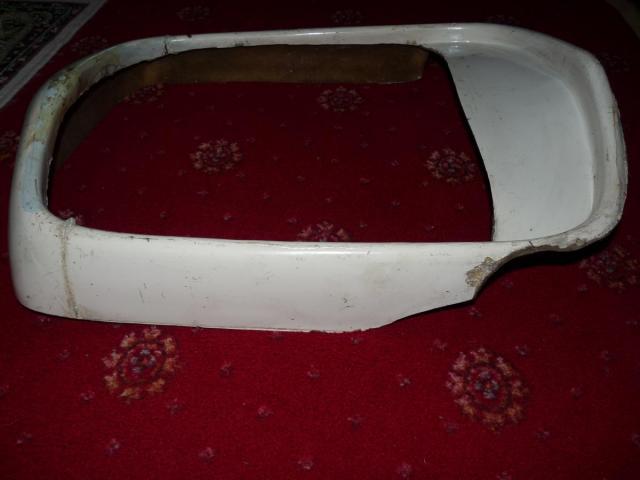

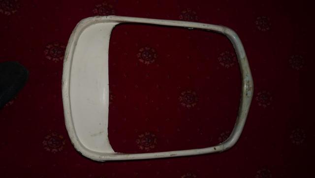

ranger 373 #156 Posted September 15, 2014 I've got a 32 Duece grille shell in the garage ;) 1 Ian reacted to this Share this post Link to post Share on other sites
nigel 1,881 #157 Posted September 15, 2014 I've got a 32 Duece grille shell in the garage ;) that would do for my next project doug have you a pict 1 Ian reacted to this Share this post Link to post Share on other sites
ranger 373 #158 Posted September 15, 2014 I'll fish it out tomorrow Nigel and take some pics. Share this post Link to post Share on other sites

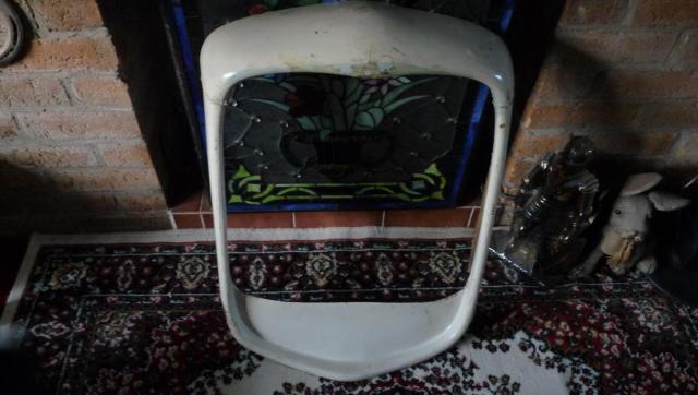

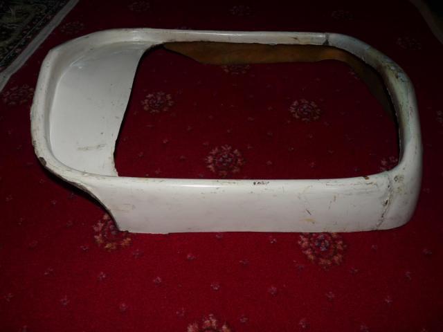

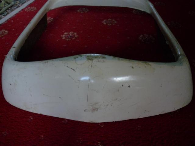

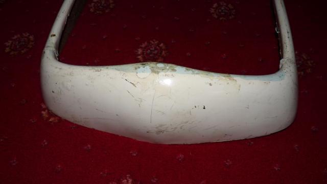

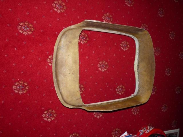

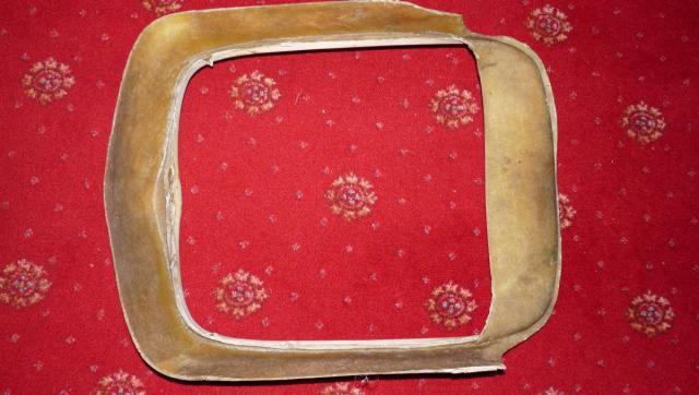

ranger 373 #163 Posted September 16, 2014 that would do for my next project doug have you a pict Hi A few pics, the shell is fibreglass & looks as though it has been roughly trimmed after coming out of the mould. A friend gave itto me about 25 years ago when I was building a model A pickup. It has hung in the garage ever since, so it should have a nice ripe flavour by now It's yours if you want it, Nigel , but you'll have to change the Land Rover engine for a Kohler if you want "A little duece coupe with a flathead mill" Share this post Link to post Share on other sites
