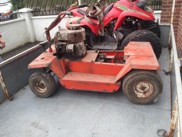

classic cars ni 0 #27 Posted February 4, 2015 Was given this a while ago..after reading this thread im gonna restore it...what do you rekon...it is complete Any ideas on engine type and year of build..thanks in advance Share this post Link to post Share on other sites
nigel 1,881 #28 Posted February 4, 2015 its well worth restoring they are quite hard to find now as the lawnmower racing boys keep choping them up, but the good thing about that is, you can buy all the parts they dont use very cheaply Share this post Link to post Share on other sites
classic cars ni 0 #29 Posted February 4, 2015 I kind of thought it was a shame to scrap it..given it is all there ..the rest is in a box..ive restored cars motocrossers bmxs old tri ang stuff but never a ride on..good to know im not the only mad one! Share this post Link to post Share on other sites
Stormin 4,458 #30 Posted February 4, 2015 Any ideas on engine type and year of build..thanks in advance Our archivists will need numbers. Engine, chassis, model. See what you can find. Share this post Link to post Share on other sites
Wristpin 400 #31 Posted February 4, 2015 (edited) From memory a Bug's chassis numbers was on a tin foil sticker so possibly not much chance of it having survived. The engine is a Tecumseh, possibly a V70. Tecumseh engines of that era had their engine details either stamped into a small metal tag often secured by one of the screws retaining the valve chest cover, or stamped into the blower housing. Tecumseh used two sets of numbers , the first giving the spec of the engine , such as the crank orientation, horse power and application and the second showing the build year and the day of build ( the day being shown as a numer between 1 and 364. Edited February 4, 2015 by Wristpin Share this post Link to post Share on other sites
