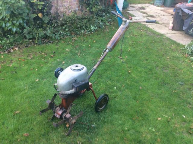

Wristpin 400 #5 Posted December 27, 2015 If you can get it, try OSPHO on the prep, it works really good on neutralizing rust. It might go by another name over their, but it leaves a clear varnish like layer that serves as added protectionSounds as though it may be similar to Owatrol which can either be added to paint or applied by itself as a patina preserver.This cultivator was just given a wash with hot soapy water and the a coat of Owatrol to preserve the original rust, paint and patina, preventing further deterioration . 2 nigel and Will-Haggle reacted to this Share this post Link to post Share on other sites
