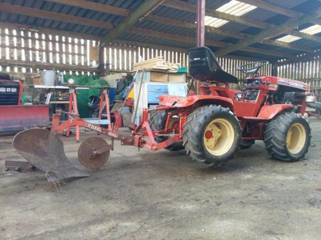

meadowfield 1,901 #1 Posted March 5, 2016 Now that Bendy is fully hydraulicised it was time to get test the plough. Yup, it works.... 10 jak3_smith, wurzel, pmackellow and 7 others reacted to this Share this post Link to post Share on other sites

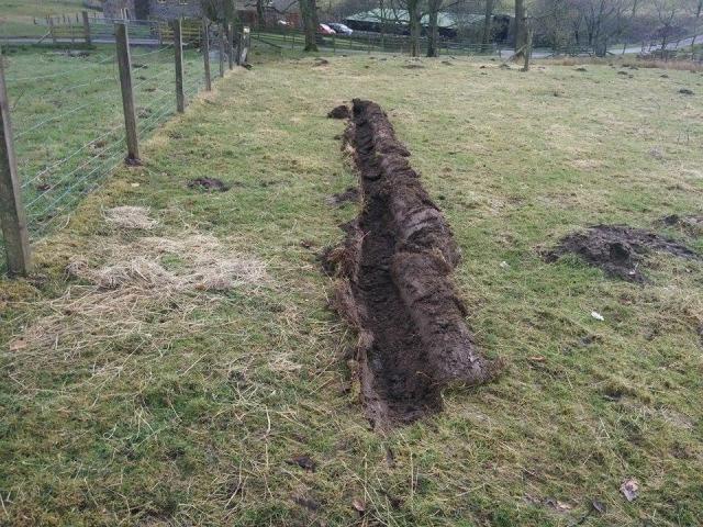

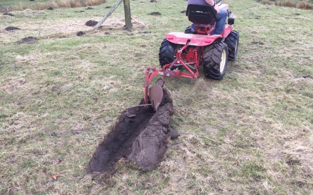

meadowfield 1,901 #2 Posted March 5, 2016 Only kidding Here's the second go, needs setting up and a better driver See what I mean 10 jak3_smith, pmackellow, Ian and 7 others reacted to this Share this post Link to post Share on other sites
Ian 2,417 #3 Posted March 5, 2016 Not bad for your first try on Bendy, your soon get the knack with some more playing 2 HeadExam and meadowfield reacted to this Share this post Link to post Share on other sites
meadowfield 1,901 #4 Posted March 5, 2016 Not bad for your first try on Bendy, your soon get the knack with some more playing Need to fix it and get back up the field Share this post Link to post Share on other sites

The Fife Plooman 632 #8 Posted March 6, 2016 Hi Try and get the heel at the rear of the plough on the ground that will give you a good starting point. you can start by adding length to the top link and work from there it is all about having fun, although it can sometimes be frustrating carry on ploughing. George S 2 Triumph66 and meadowfield reacted to this Share this post Link to post Share on other sites

DevonianRedneck 86 #16 Posted March 24, 2016 looking good, but like the fife plooman says a longer top link will help, when the ploughs in the ground, there should be barely any pressure on the top link (it should almost be floating as such) all the pressure should be on the lower links, ideally for conventional ploughing you need an adjustable right hand lower link so you can angle the plough differently when cutting in to when your ploughing normally Share this post Link to post Share on other sites
HeadExam 1,783 #17 Posted March 25, 2016 Yep, gotta get the suck leveled out Share this post Link to post Share on other sites
