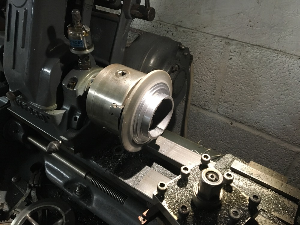

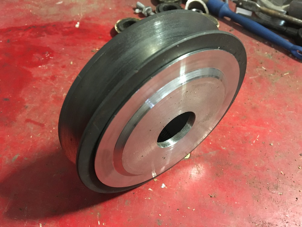

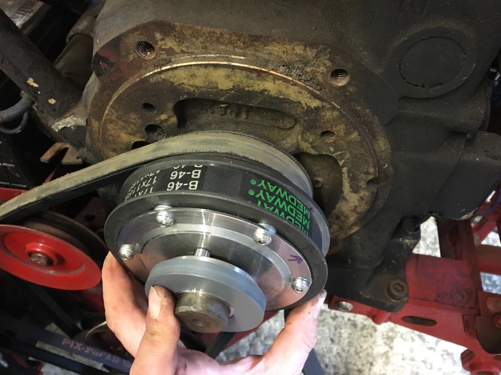

meadowfield 1,901 #1 Posted August 15, 2016 Whilst you were all enjoying yourselves at rpt, I took some time away from diy and plumbing to have a go at something I've been thinking of for a few years. wheel horses don't shift gear on the move well, and often you might need to slow down a bit for some power, or speed up. so with the idea of Powershift on the old internationals I spent about 12 hours at the lathe and came up with this. A split pulley system allowing a 20% increase in speed at the pull of a lever. So that's 12 forward speeds - and another gear lever to find a place for. Of course if the system works... hopefully get get to have another look when I get home on Friday. 4 HeadExam, pmackellow, Stormin and 1 other reacted to this Share this post Link to post Share on other sites

meadowfield 1,901 #4 Posted August 15, 2016 Same principle as variomatic. Just two positions, low in the pulleys with no thrust on the end is low speed. High on the pulleys with them closed together is high speed. Not or aware anyone has ever done it before, though the principle is well established. DAF did it in the 50s, the system is still in use. Share this post Link to post Share on other sites

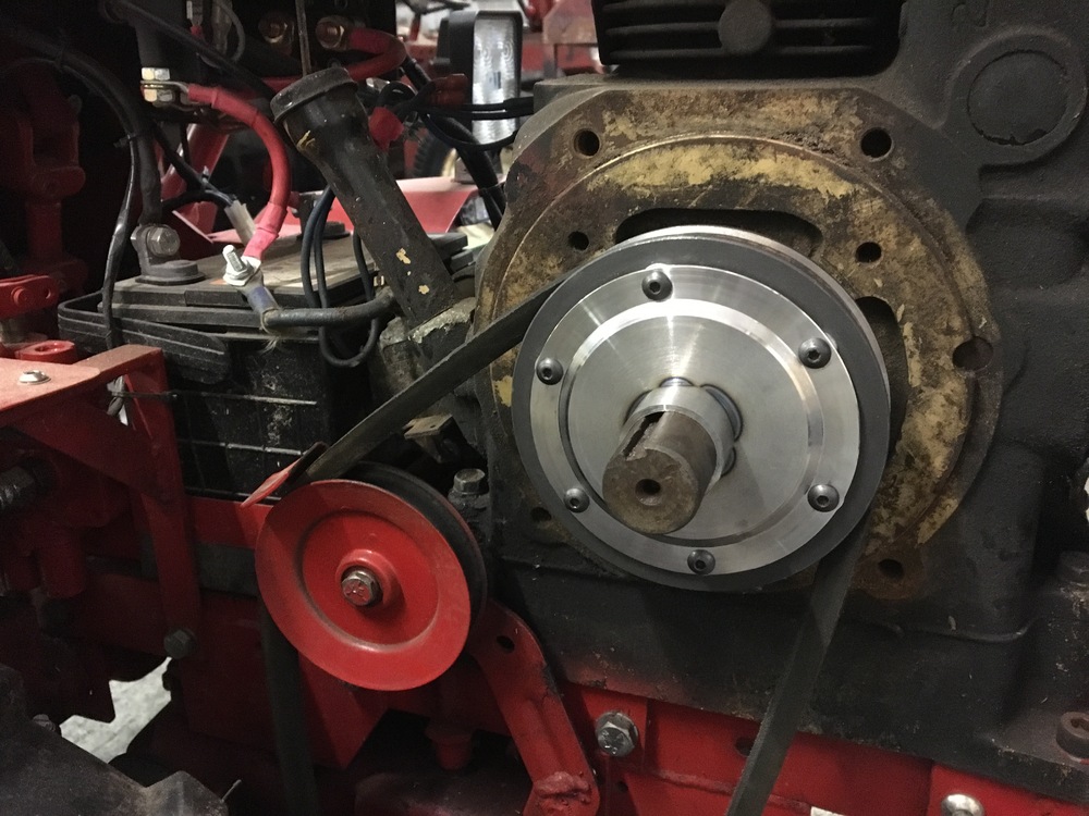

ranger 373 #16 Posted August 16, 2016 Rather than two expanding /contracting pulleys, how about using the wheelhorse pto clutch lever and gubbins, there's a good word, to push/pull the outer sheave of the pulley, and have a link to the idler/tensioner pulley to keep the belt tension right at both ratios. Share this post Link to post Share on other sites
meadowfield 1,901 #17 Posted August 16, 2016 5 minutes ago, ranger said: Rather than two expanding /contracting pulleys, how about using the wheelhorse pto lever and gubbins, there's a good word, to push/pull the outer sheave of the pulley, and have a link to the idler/tensioner pulley to keep the belt tension right at both ratios. Im only using one pulley, with the idler taking the slack. I would use the pto lever, but two three point levers have popped up there. So looking for a new home. Tempted to make it electric shift for the hell of it Share this post Link to post Share on other sites

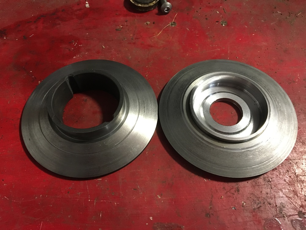

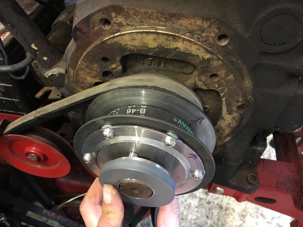

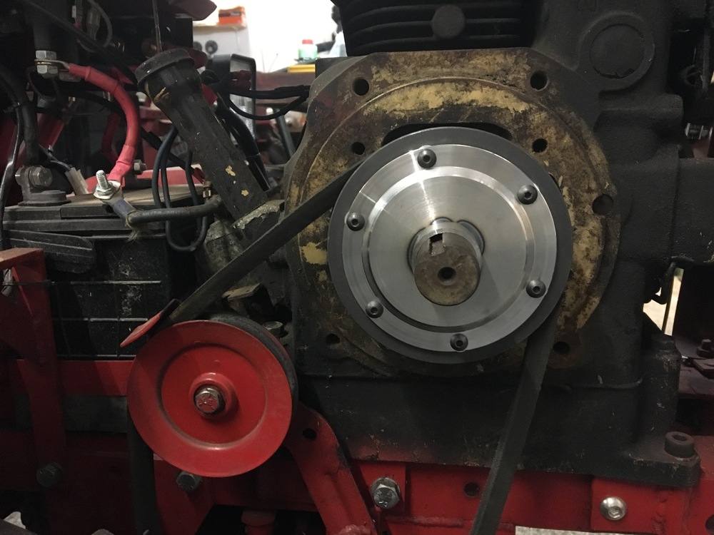

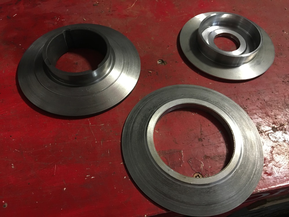

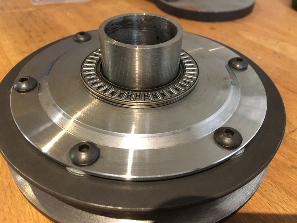

meadowfield 1,901 #22 Posted August 21, 2016 That was my plan originally, but I'm short on space... heres todays update, the two halves are spring loaded, with a custom thrust bearing and selector fork. Just the actuator to complete. Share this post Link to post Share on other sites

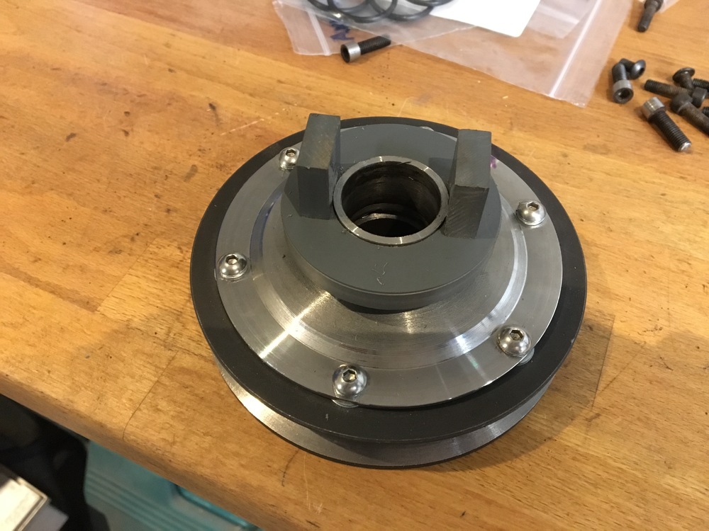

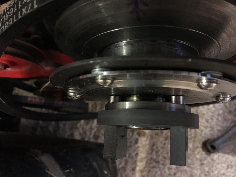

meadowfield 1,901 #25 Posted September 25, 2016 Spent a bit more time, fork done. Just the actuator to sort. I've tested the pulley at fixed settings, and manually pushed the fork with the engine running. 5 wurzel, Stormin, HeadExam and 2 others reacted to this Share this post Link to post Share on other sites
