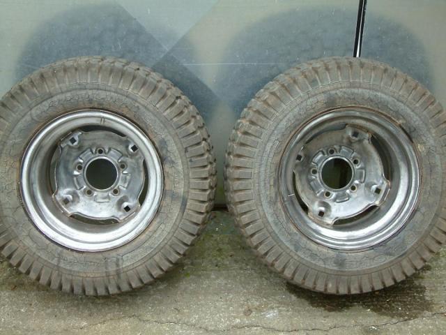

Stormin 4,458 #292 Posted May 16, 2015 Started on the rear wheels today. After about 4hrs with flap wheel, wire wheel and emery cloth, they are bare metal. That is except for the outer centres. Can't really get at them with flap/wire wheels. So an experiment is in progress. They are now spending the night with a coat of brake fluid on the remaining paint. (I've no paint stripper.) Also took the drive pulley off the trans' and it didn't 'arf put up a fight. Tomorrow I'll replace the weeping seal. Share this post Link to post Share on other sites

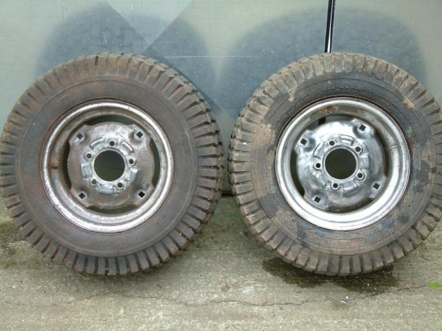

Stormin 4,458 #294 Posted May 17, 2015 The wheels spent the night with a coating of brake fluid. It did soften the paint but not by much. SWMBO then informed me she had some paint stripper in her studio. Gave the centres two coats as per instructions and the paint scraped of easily. Finished them of with some wire wool and the result is below. They are now all masked up ready for painting. I also got the seal changed on the drive pulley spindle. I'll have to wait to see if that's successful. Share this post Link to post Share on other sites
the showman 4,074 #295 Posted May 17, 2015 Hate doing wheels, i just run mine down my local blasters, then i only have to spray them. Your doing a great job Norm but its so time consuming Share this post Link to post Share on other sites
Stormin 4,458 #296 Posted May 17, 2015 , Hate doing wheels, Why do you think I've left them to last, Chris. About 6-7hrs.to get them like that. Share this post Link to post Share on other sites

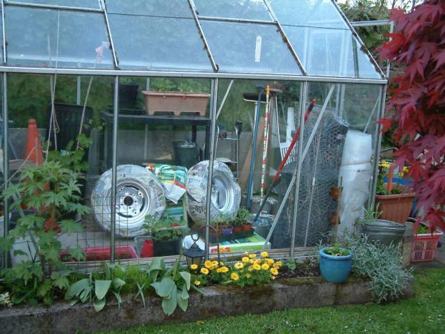

Stormin 4,458 #297 Posted May 18, 2015 Weather turned sunny this afternoon, so out came the paint. Two coats grey primer, two grey undercoat and two of silver. In between coats a spell in the low bake oven. That's where they are now. 3 meadowfield, S1g and nigel reacted to this Share this post Link to post Share on other sites
Charlie Smith 192 #298 Posted May 18, 2015 looking good Share this post Link to post Share on other sites
the showman 4,074 #299 Posted May 18, 2015 They look nice Norm, I like your oven plenty of light Share this post Link to post Share on other sites
Stormin 4,458 #300 Posted May 18, 2015 Had to get special permission to use it Chris. 2 the showman and S1g reacted to this Share this post Link to post Share on other sites
