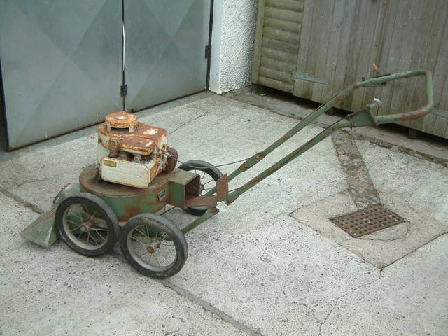

Stormin 4,458 #1 Posted August 25, 2016 This Billy Goat is something else I brought back from down south. Although I've rotated the first photo the right way up, it keeps coming up like this. The engine is a 5hp B&S. Had a bit of a look at it today. Compression is good but no spark. Plug ok. Tried it on one of the tractors. Pull start freed up and working. Also height adjustment now working. I need a puller for the flywheel to get at the points. Till then I'll remove and clean tank and carb. Once I get it running and see how it performs, then I'll decide what I'm going to do with it. I doubt it'll stay as is. 2 Ian and DougC reacted to this Share this post Link to post Share on other sites

Anglo Traction 1,018 #10 Posted August 26, 2016 Hi Norm, I remember seeing that and others when I visited John and Alan last year. Glad to see you may have a use for it. Can you post your Engine Model and Serial numbers off of the Blower Housing please?. Good to be able to meet and have a brief chat with you at RPT . Share this post Link to post Share on other sites
Stormin 4,458 #11 Posted August 26, 2016 Good to meet you as well, Richard. So far I have found out the Billy Goat is 1978 or a little earlier. Model KD50. Serial 24539. B&S 5hp engine. The following numbers are on the side of the cowl. Only ones I can find. 130902 0456-01 76042006 Share this post Link to post Share on other sites
Anglo Traction 1,018 #12 Posted August 27, 2016 Engine build date is 1976 Norm. User and Parts Manual are *here* for it. I have a Briggs W/Shop Manual for any Torque/Gap Settings, procedures etc if you need them. Engine Models 100000/130000 have no Flywheel Puller facility, so Koen is correct with the Flywheel procedure. If you are doing it alone, gently tap 2 wooden wedges 'tween the Flywheel n Alloy Case just enough to take up Crank end play (a few thou). Hit opposite sides of the Flywheel simultaneously with Soft faced/covered hammers until it is free. Condition of the Flywheel/Shaft Key is important. If you need any help locating parts, drop me a PM. Share this post Link to post Share on other sites

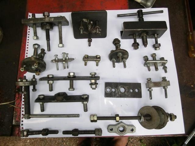

Wristpin 400 #19 Posted December 20, 2016 (edited) Legged pullers that hook under the flywheel are a strict NO, NO. You can end up with a split flywheel or worse still a cracked one that flies apart later. Make what you need when you need it - will always come in useful! Edited December 20, 2016 by Wristpin image added 2 Ian and slf-uk reacted to this Share this post Link to post Share on other sites

C-101plowerpower 548 #22 Posted December 21, 2016 10 hours ago, Wristpin said: Legged pullers that hook under the flywheel are a strict NO, NO. You can end up with a split flywheel or worse still a cracked one that flies apart later. Make what you need when you need it - will always come in useful! i see atleast one oem puller in there Share this post Link to post Share on other sites
Wristpin 400 #23 Posted December 21, 2016 (edited) 3 hours ago, C-101plowerpower said: I see at least one oem puller in there Two BS ones both with their holes elongated to fit other things. One item that is not there is is a starter clutch spigot protector and knocker. On BS engines with the ball engagement starter clutch there is a temptation to remove it and then hit the top of the spigot to dislodge the flywheel . Don't do it as even the slightest distortion of the spigot will lead to screaming starters and wrecked recoil springs but the after market protector with a brass insert makes the job easy and safe. Briggs contact breaker / condenser set, 294628 £15.15+vat , is still readily available but with so many good used Magnetron coils around for less money there's little point (sorry) in making work for the fun of it. Most mower shops have a box of "may come in useful" Magnetron coils from wrecked engines. Just need to make sure of the exact dimensions between fixing screws as there are some small dimensional differences between what appear to be similar engines. Edited December 21, 2016 by Wristpin Typo! Share this post Link to post Share on other sites
