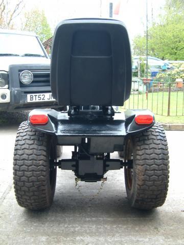

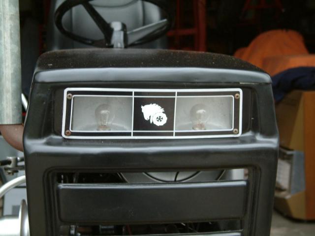

Stormin 4,458 #259 Posted May 8, 2015 A little bit more done today. A front light lens graphic, to replace the broken lens came from Mark in the post. So that was fitted to the lens I made, along with the nicely painted light case. I also fitted the rear lights. I also painted two standard hitches and a slot hitch, plus some other bits. Share this post Link to post Share on other sites

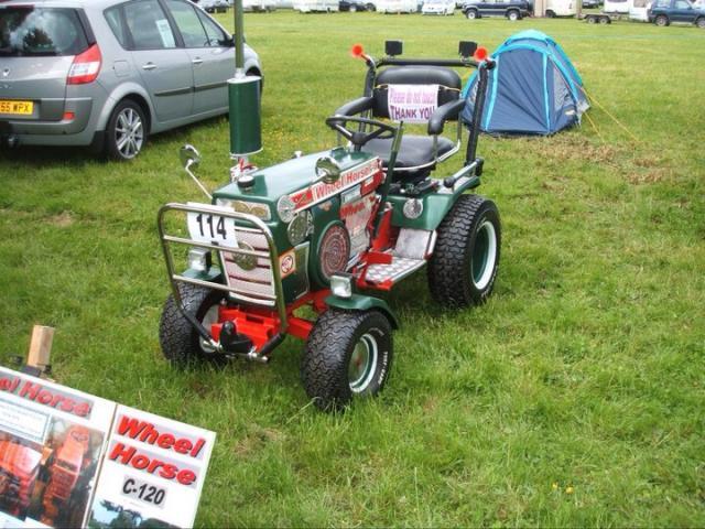

Rocboni 257 #261 Posted May 8, 2015 (edited) Glad you didn't paint it green like this one! I'm not sure what it's meant to be. Edited May 8, 2015 by Rocboni 1 bowtiebutler956 reacted to this Share this post Link to post Share on other sites
the showman 4,074 #262 Posted May 8, 2015 OMG, OTT, OW Share this post Link to post Share on other sites
Stormin 4,458 #263 Posted May 8, 2015 I kinda like that. Wheel Horse mobility scooter. Share this post Link to post Share on other sites
nigel 1,881 #264 Posted May 8, 2015 i think i know the story about this ,the owner is colour blind and his kids painted it for him and told him it was red, just like the showmans horses Share this post Link to post Share on other sites
bowtiebutler956 166 #265 Posted May 9, 2015 Glad you didn't paint it green like this one! I'm not sure what it's meant to be. I don't even know what to say about that. Its very interesting. Matt Share this post Link to post Share on other sites

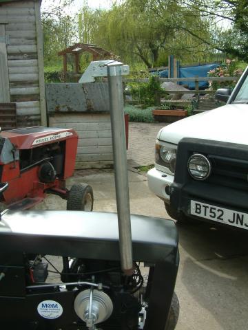

Stormin 4,458 #266 Posted May 9, 2015 Paid a visit to Jonathan, (expeatfarmer) while out this morning. As we talked and perused his latest acquisition, something caught my eye under a bench. A length of stainless pipe with a flap on. Surplus to his requirements, it found it's way into the Discovery. Back home and a bit of scrating about in the workshop, some welding, some lath work, some drilling and the result is below. Not what I expected to do today, so thanks Jonathan. 2 slf-uk and Ian reacted to this Share this post Link to post Share on other sites

Tom 215 #268 Posted May 9, 2015 Looking good Norm, bet it sounds good! Tom Share this post Link to post Share on other sites
Stormin 4,458 #269 Posted May 9, 2015 All being well I'll let you know next week, Tom. Not wired up yet. Share this post Link to post Share on other sites
Ian 2,417 #270 Posted May 10, 2015 A nice finishing touch Norm, you can't beat a shiny stack Share this post Link to post Share on other sites
bowtiebutler956 166 #271 Posted May 10, 2015 I think that compliments your C-120 perfectly. It will now sound as mean as it looks! Matt Share this post Link to post Share on other sites
