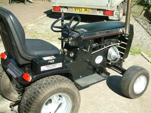

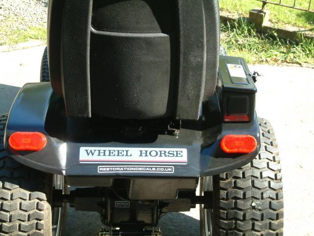

Anglo Traction 1,018 #326 Posted June 9, 2015 Stickers applied at Newby Hall courtesy of Mark. I also added a little something I picked up at Newby, to the right side of the fender. Photo tomorrow. Stickers look good Norm. Did Mark make them with Chrome/Silver?. You Teaser.......making us wait Share this post Link to post Share on other sites

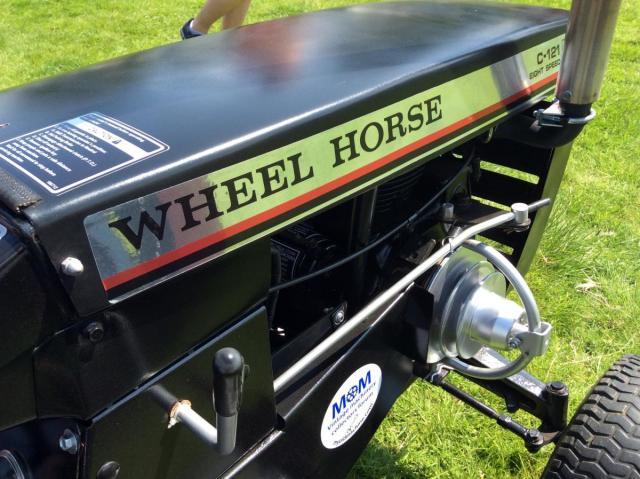

meadowfield 1,901 #327 Posted June 9, 2015 Looking good, here's one I took. Yes Richard, they are chrome and laminated. Look great, but expensive to make. I think the effect is worth it though. Share this post Link to post Share on other sites
Stormin 4,458 #328 Posted June 9, 2015 I'll take some more sticker photo's tomorrow. I didn't mean to tease, Richard. Went out to take a photo, but someone had put the Spitfire in the way. Share this post Link to post Share on other sites
bowtiebutler956 166 #329 Posted June 9, 2015 There is nothing that brings out the finished product better than a fresh set of decals. Looks Great! Matt Share this post Link to post Share on other sites

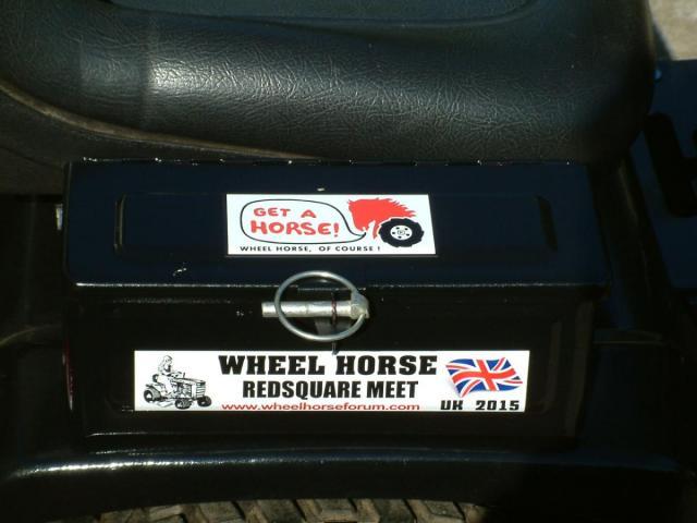

Stormin 4,458 #330 Posted June 10, 2015 Photo's as promised. 1 nigel reacted to this Share this post Link to post Share on other sites
Anglo Traction 1,018 #331 Posted June 10, 2015 I'll take some more sticker photo's tomorrow. I didn't mean to tease, Richard. Went out to take a photo, but someone had put the Spitfire in the way. .................Wonder how many Pilots have said that in the past?. Very nice Norm. Like the Sandwich Box ! ......Can't be for Tools, you shouldn't need any after that Rebuild 1 nigel reacted to this Share this post Link to post Share on other sites
Stormin 4,458 #332 Posted June 10, 2015 Going to put a mouse trap in it at the Silloth Vintage Rally, Richard. See if I can catch any fiddling fingers. 1 Alan reacted to this Share this post Link to post Share on other sites

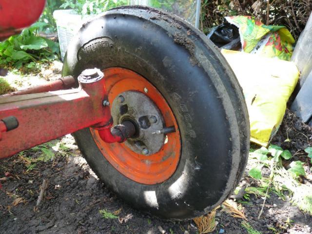

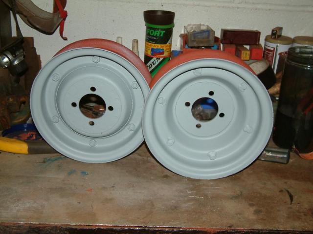

Stormin 4,458 #335 Posted June 28, 2015 Managed to get a bit of workshop time today and got some bit jobs done on the Black Horse. (1) Clutch pedal rod adjuster nut freed off. Pedal doesn't need pressing as far forward now. (2) Slight play in right rear hub taken out. About 6 thou difference in hub bore and drive shaft diam. Sorted by use of hammer and centre punch to inside of hub. Crude but effective. Nice and tight now. (3) New gaiter fitted to bottom of gear lever. (4) Stop made and fitted to prevent brake pedal from coming to far back. (5) Is on going. Cleaning up a pair of scooter split rim wheels I got at Newby Hall. These are just right for fitting to the front with tri ribs on. Goodness knows what they've been painted with, but it's like concrete. Ready to paint now, after some filler is applied to the rather corroded insides. (6) Started to clean up the front tachomatic. BTW. The little tool box, along with a second, is an MF item. 3 S1g, ranger and nigel reacted to this Share this post Link to post Share on other sites
Stormin 4,458 #336 Posted July 7, 2015 Afore mentioned wheels primed. Should have taken a before photo. Look a bit better, eh! Chris? 2 S1g and bowtiebutler956 reacted to this Share this post Link to post Share on other sites

the showman 4,074 #338 Posted July 7, 2015 They look better Norm, you've made a good job Share this post Link to post Share on other sites

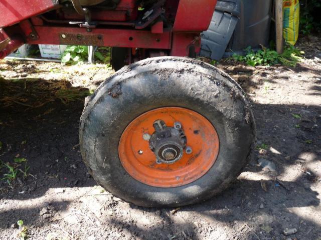

Ian 2,417 #339 Posted July 8, 2015 I'm guessing you have a wheel hub conversion planned Norm looking at those wheels.. The silver decals and black paint look great by the way Share this post Link to post Share on other sites
Stormin 4,458 #340 Posted July 8, 2015 Your right Ian. Just need to find some suitable hubs or make my own. Re-fitted the newly painted front and centre tachomatics today. Who knows, I may need them for Rural Past Times. I'd best get the rear one done as well. Plus lift cable. Share this post Link to post Share on other sites
C-101plowerpower 548 #341 Posted July 8, 2015 wont hups off of a gt 14 or the like work? those are 4bolt right? Share this post Link to post Share on other sites
Stormin 4,458 #342 Posted July 8, 2015 I've no idea and I don't have any, Koen. Suspect the spindles will be different anyway. Share this post Link to post Share on other sites

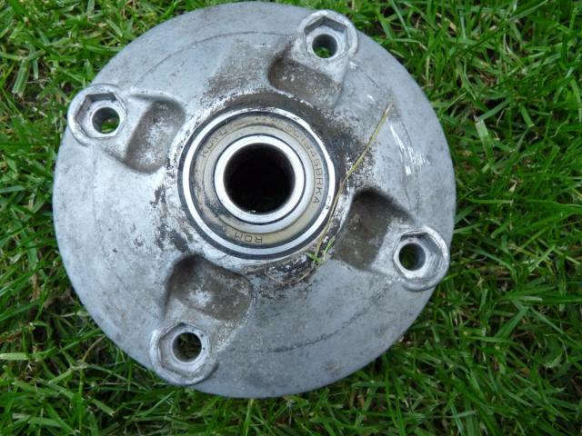

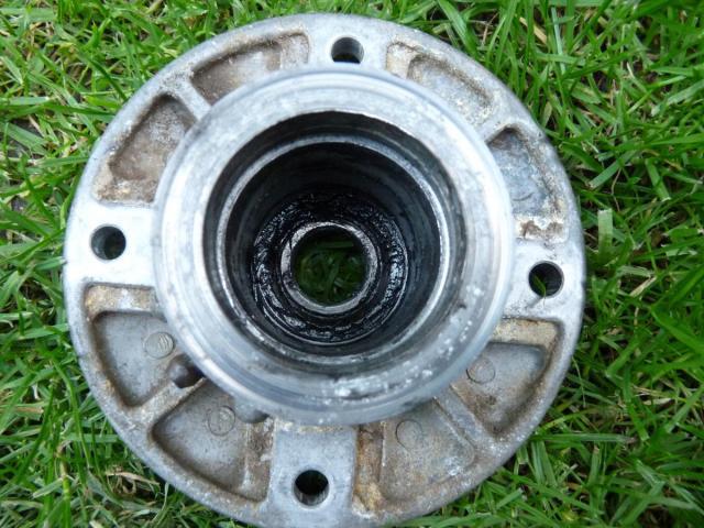

ranger 373 #347 Posted July 9, 2015 What PCD are the wheels Norm, I used JD mower deck spindles for my C121 front hubs. I'm sure I have some more, I think the pcd of these is around 100mm / 4" the bearing size is 3/4" so they go straight on. You can alter the track by just turning them round. if you want to try them, PM me and I'll send you a couple. Doug Share this post Link to post Share on other sites
Stormin 4,458 #348 Posted July 9, 2015 They look good Doug. But I'm not sure the hub OD will fit inside the dish of my wheels. PCD on the scooter wheels is 2-3/4". Centre hole in the wheel is 2-1/8". Share this post Link to post Share on other sites
Stormin 4,458 #349 Posted July 14, 2015 Bit the bullet today and bought some hubs, bearings etc. Spent the afternoon boring out the wheel centres and re-drilling the stud holes. Now all I need now are wheel spindles. Forgot about them. 2 slf-uk and the showman reacted to this Share this post Link to post Share on other sites
