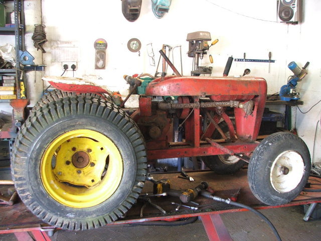

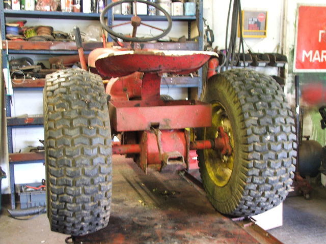

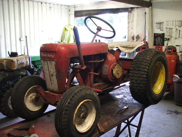

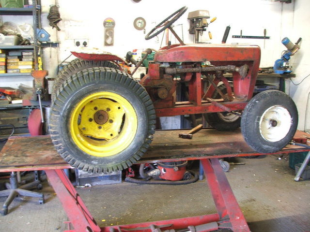

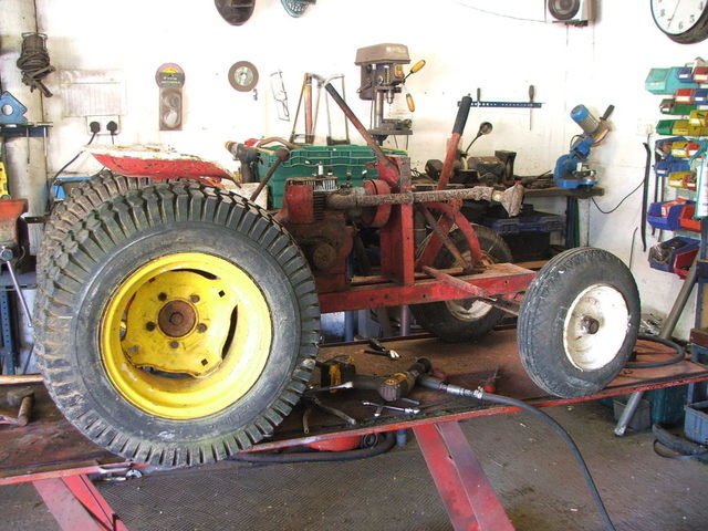

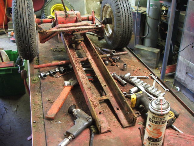

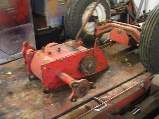

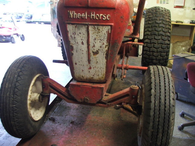

nigel 1,881 #1 Posted November 10, 2016 picked this up the other day, every thing was seized up on it, but it has compresion so thought i would strip it and get it working again 10 Triumph66, Don, 4x4forks and 7 others reacted to this Share this post Link to post Share on other sites
Wallfish 718 #2 Posted November 11, 2016 Too bad that muffler is blown out. Those go for some big money. By the way, that tractor is a 1960 model 400 1 nigel reacted to this Share this post Link to post Share on other sites
Joseph 335 #3 Posted November 11, 2016 I really like those older small Wheelhorses, looking forward to seeing further updates. I don't know much about these types of Wheelhorse because dad has a sheds full of Bolens. 3 Triumph66, Cub Cadet and nigel reacted to this Share this post Link to post Share on other sites
harryt 281 #4 Posted November 11, 2016 Sure is a nice project, will look forward to seeing the progress, shame about the painted yellow wheels Share this post Link to post Share on other sites

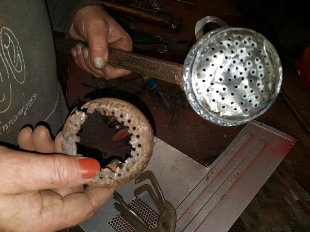

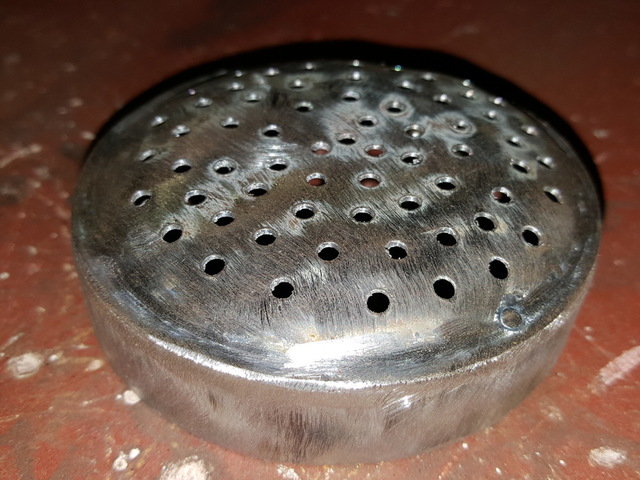

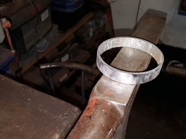

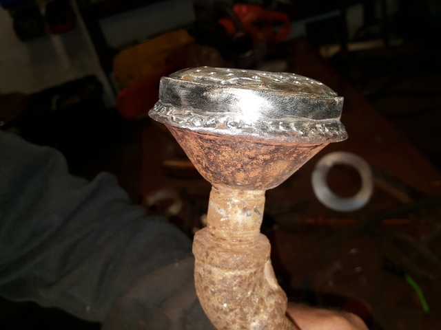

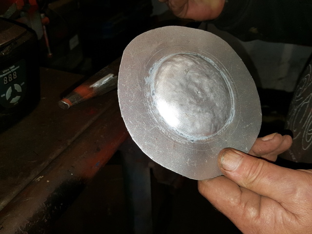

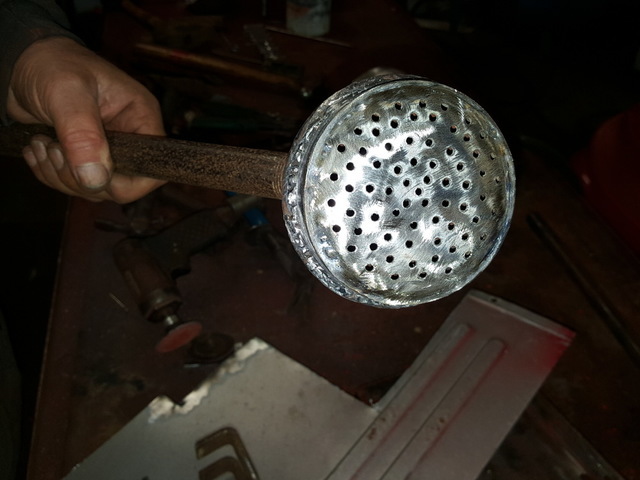

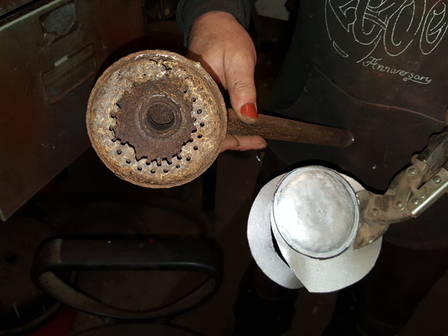

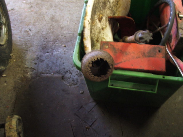

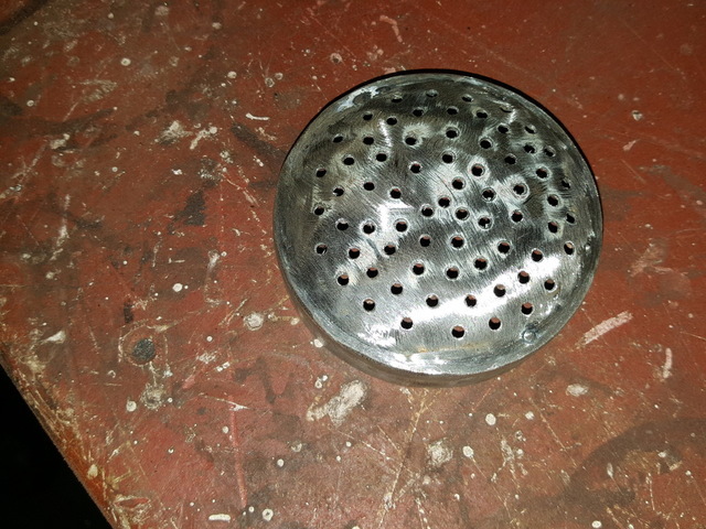

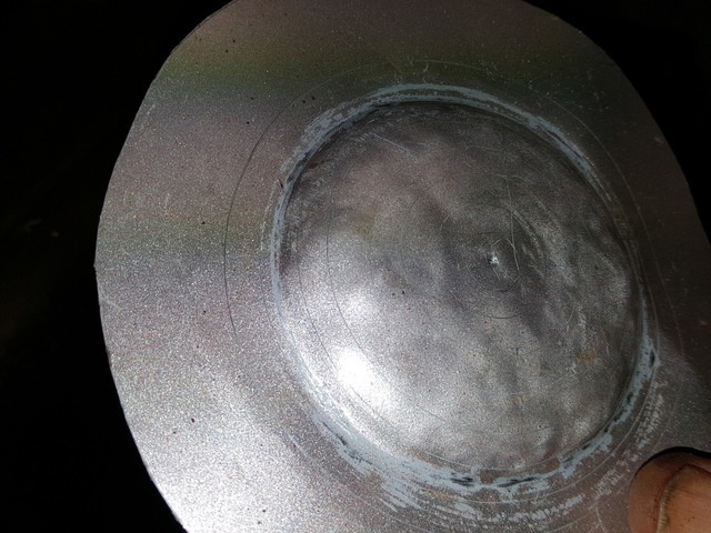

Ian 2,417 #14 Posted November 17, 2016 Evening all, a few photo's of Nigel's exhaust repairs.. Starting with a bit of pipe. A bit of beating... Taking shape. You can just about make out the "holes circles" in this photo.. Snip snip. Some welding and quite a bit of drill later.. The welds around the side still need a bit more grinding back in this photo. Old verses new.. I know which one looks better 7 pmackellow, Stormin, slf-uk and 4 others reacted to this Share this post Link to post Share on other sites
Stormin 4,458 #15 Posted November 17, 2016 I bet he was exhausted after all that work. 3 slf-uk, Alan and Triumph66 reacted to this Share this post Link to post Share on other sites
nigel 1,881 #16 Posted November 17, 2016 31 minutes ago, Stormin said: I bet he was exhausted after all that work. Don't be so rude 1 Triumph66 reacted to this Share this post Link to post Share on other sites
neil 524 #17 Posted November 19, 2016 Nice job , I was wondering if you were going to save the existing exhaust Nige , well done ,kept it original . 1 nigel reacted to this Share this post Link to post Share on other sites
ranger 373 #18 Posted November 19, 2016 All that effort and you could have used a tea strainer 1 nigel reacted to this Share this post Link to post Share on other sites

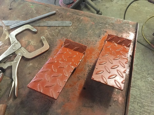

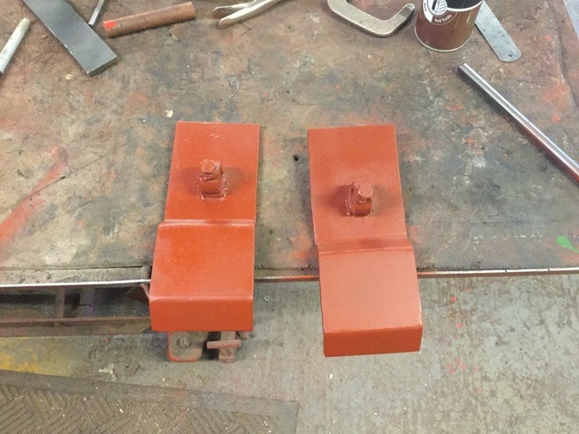

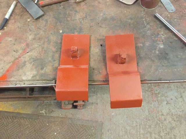

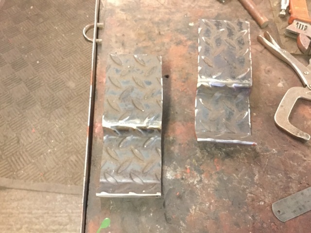

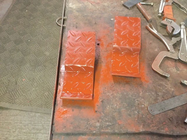

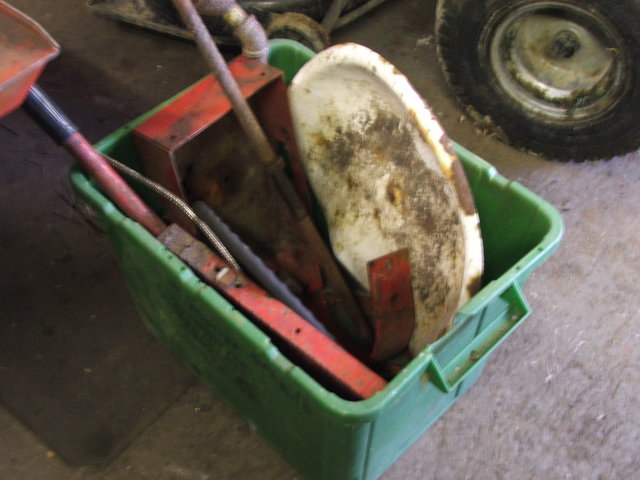

nigel 1,881 #19 Posted November 22, 2016 Made some foot plates today as they were missing Share this post Link to post Share on other sites
the showman 4,074 #20 Posted November 22, 2016 Rear fenders fitted when new 3 Triumph66, slf-uk and pmackellow reacted to this Share this post Link to post Share on other sites

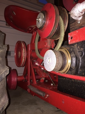

Wallfish 718 #21 Posted November 23, 2016 Found this instruction to be interesting. HIGHLY doubt many people are going to remove and replace the belt guard every hour to grease that idler pulley. This could possibly explain why so many belt guards are missing. 2 nigel and slf-uk reacted to this Share this post Link to post Share on other sites
